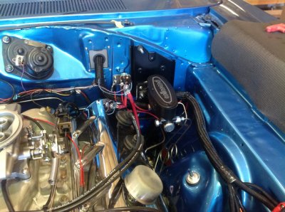

Well, I went with the 1" bore master cylinder and finished the install yesterday. Here is a pic. Certainly looks cleaner than the factory unit. Hopefully get to drive it late next week and see how it stops. Thanks for all the input everyone.
That's what I'm using on my 64 Polara, but I have power brakes and 11.75 disc's in front. That install looks very clean!!!
