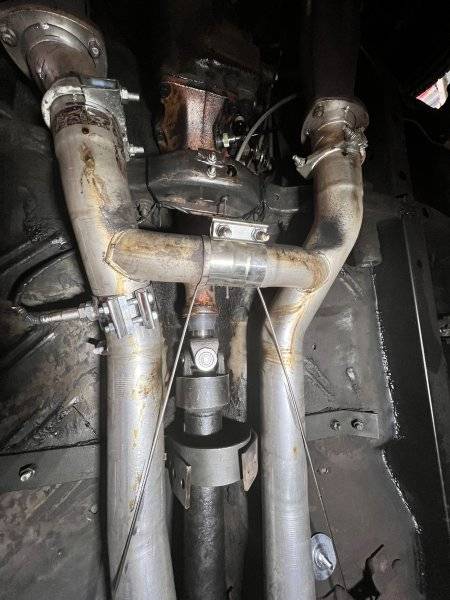

Here’s the slip yolk at ride height. I don’t believe it’s too far in or too far out.

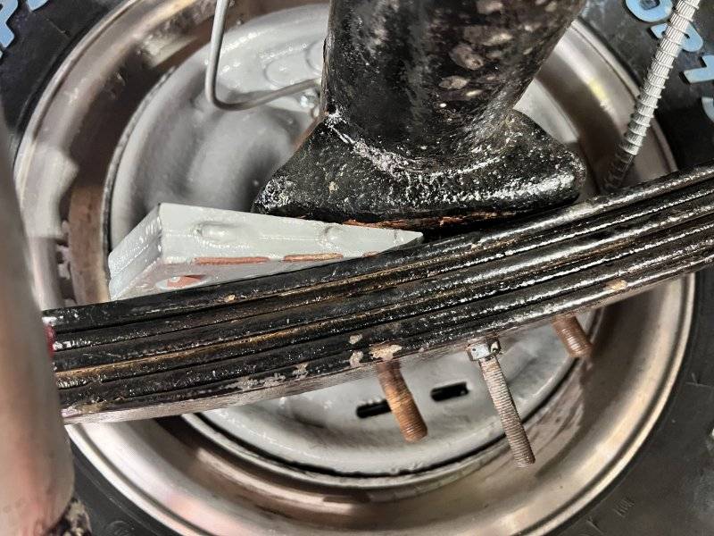

I did notice I have a chunk missing in one of my rear drums but I’d assume that if this was the case it would vibrate constantly and not just when in neutral coasting

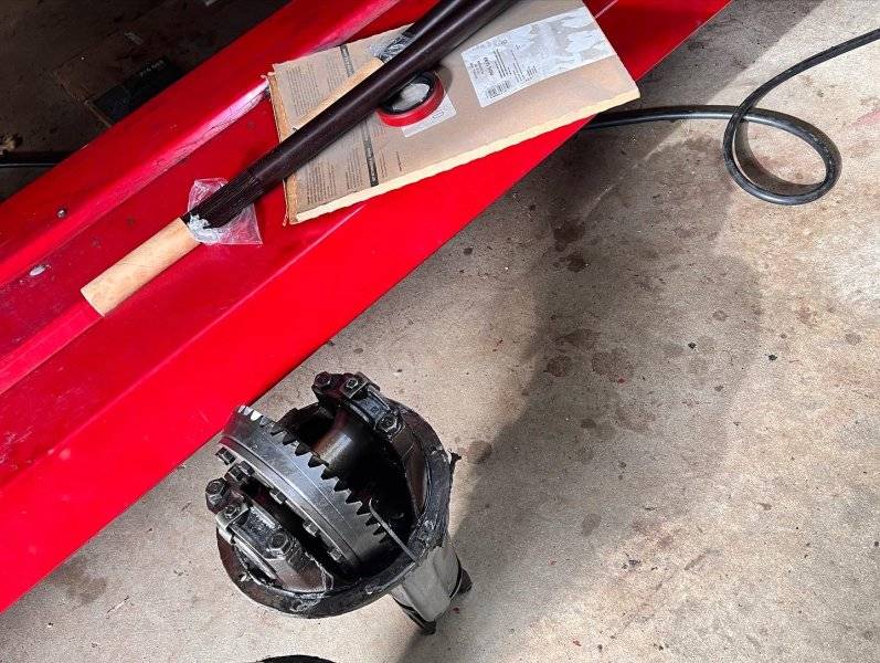

New axles and different pig so I should be able to eliminate possible axle, bearing or rear gears causing vibration

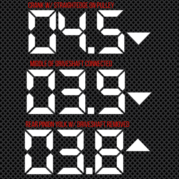

These were the angle measurements

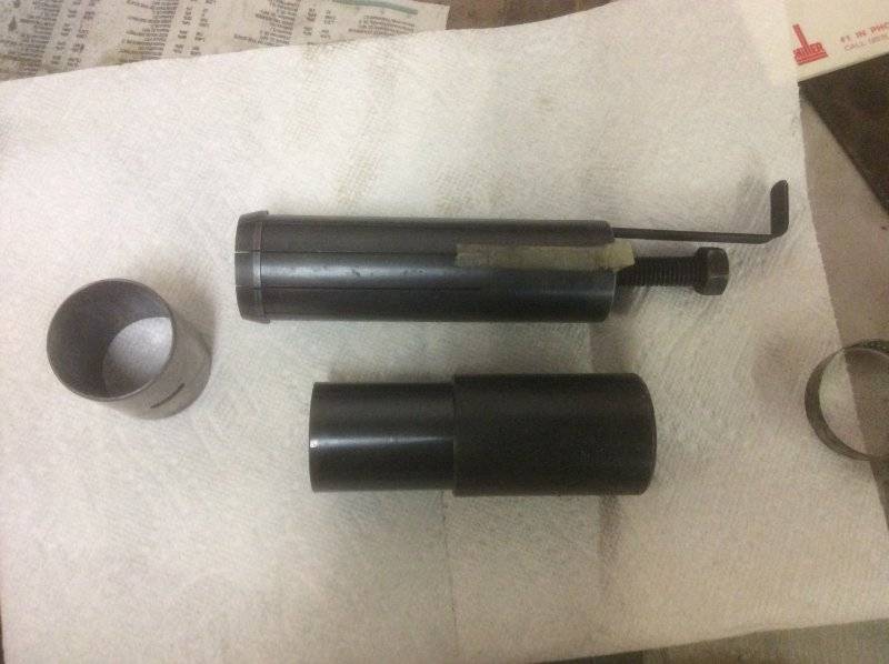

I don't know if it is this because my vibration was at 65 mph and up. Tailshaft yoke bushing, there should be no up and down movement. Mine was .013 clearance I measured after I pulled it. Edit There should little to no movement.

Less than 1* between tail shaft and drive shaft. I’ts my understanding that your need at leas 1* difference. I’d try raising the tail shaft to gain at least 1 degree difference.maybe shoot for 2* trans to driveshaft.
Also looks like your near parallel driveshaft to rear pinion. Under load your pinion is to high. Remove shims. I’d shoot for 3* difference with rear pinion looking down relatively to driveshaft.
If this was in my garage, I'd remeasure the driveline angles at the joints again just to confirm the angles. I would set the pinion angle down just a smidge to account for axle wrap while under a load if they are off. Once that is confirmed and within spec, I'd start to look into front slip yoke splines and output shaft splines. Any excessive wear in the splines will show while coasting and disappear under load. Same with the rear yoke, make sure its tight too. If all of that checks out, go after the U-Joints. I have seen where the needle bearings get damaged during replacement. This can lead to a cap not seating properly. Sometimes a simple smack of a hammer on a u joint will seat it but you should disassemble it and inspect. If the U-Joint is the problem, it can present itself only under coasting or only under load.

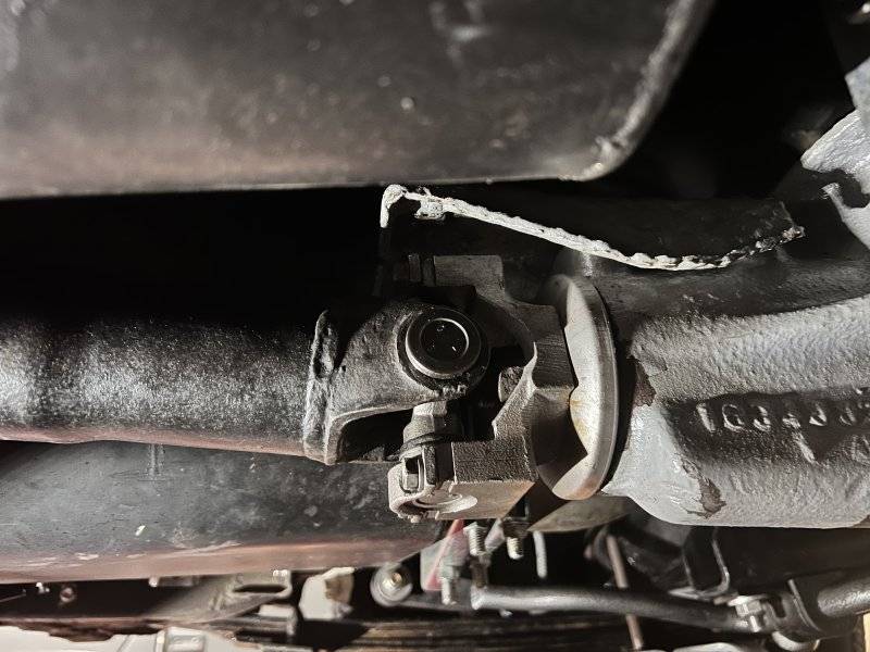

The U-Joint cap in this pic really bugs me. It looks like it is sticking out too far. Did a needle fall in, preventing the cap from seating properly?
If needle bearing didn't fall in d-shaft would off center. Bet no C-clip. If needle fell it's probably by now letting d-shaft wobble.
I don't know if it is this because my vibration was at 65 mph and up. Tailshaft yoke bushing, there should be no up and down movement. Mine was .013 clearance I measured after I pulled it. Edit There should little to no movement.View attachment 1340078
you mean if I push up and down on the driveshaft yolk going into the trans there should be little to no movement or pull the driveshaft out and just try and move the output shaft by itself?
I really can't go any higher with the transmission. It is already very close to the floor and the exhaust is almost touching the crossmember. If I shim the trans up anymore, the exhaust will hit and the trans will be almost touching the floorpan
C clips are on the inside and both are present and sitting in the appropriate grooves
