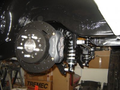

Got a list of what you have done to the suspension
I run a Martz Chassis in this car. Similar to other aftermarket front ends but they are weld in. You have to cut the shock towers out
to put the front suspension clip in.I went with there suspension because of that.I wanted to have as much bracing in the car as possible.I guess I could have put a cage in it and I would have achieved the same.LOL
Here are pics of the front and rear suspension. The front suspension came with a sway bar. The rear suspension didn't.I bought one
from Welder Series that you cut and build to your own specs and I tucked up in front of the axle so I could still get the exhaust through.I run a 3 turn lock to lock rack and pinion on the car.I was going to do the 2.5 lock to lock but realized with the horsepower of the car I felt that slower steering would be better for correcting when I get out of control.

That looks like quite the setup Glad to see people out enjoying their cars not just trailer queens
Steer with the rear tires or skinny peddle...LOL,
really looks like fun, looks like it corners relatively flat too,
nice job, sounds great too...
