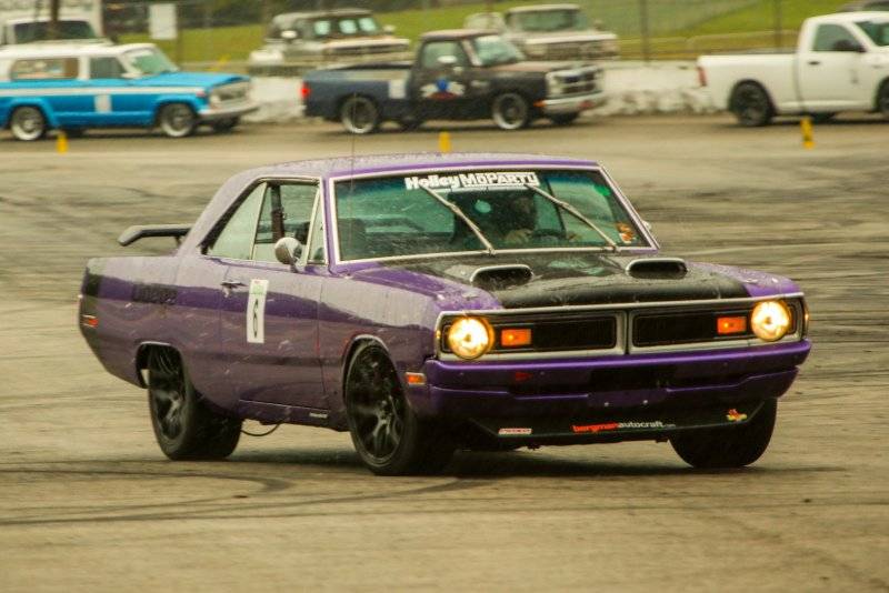

Here is a shot of good suspension geometry. Using our 2.0 SPC arms with taller ball joints and F spindles (taller) geometry changes for the better. For those concerned about F spindles, the SPC arms feature higher articulation ball joints than the typical K772. Combine with 7.5 degrees caster and only .5 deg neg camber, roll is reduced and the camber curve improves. The best result for those who say this is “racing stuff” is street drive ability. Tracking is improved greatly. No need to worry about ruts the road or constant steering correction.
Bergman Auto Craft has you covered.

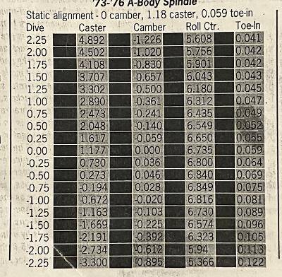

As the suspension moves toward full compression, the caster and camber gains are excellent. Look at this chart:
At 2" below stock height, you've gained over 3 1/2 degrees of caster with stock arms.
At what cost to roll center and bump steer though? There are usually better ways than lowering to gain caster/camber, like the SPC 2.0 upper arms Peter mentioned (which are on my "to buy" list.

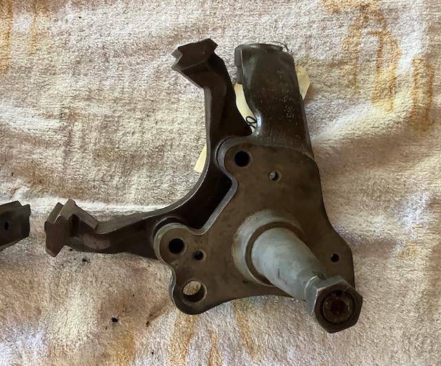

Technically, the component in this picture:
...Is a steering knuckle (With a slider type caliper bracket attached). The "spindle" is the part where the rotor or drum attaches. People seem to defer to calling these things spindles when they are actually knuckles.
I have two pair of the FMJ knuckles/spindles. They are 3/8" taller than the stock B/E/A knuckle/spindle. There was belief by some that the taller knuckle could result in the upper ball joint being at too much of an angle at full suspension travel. It has been proven numerous times to be false. The option of ball joints with a greater range of travel may be a good thing regardless.

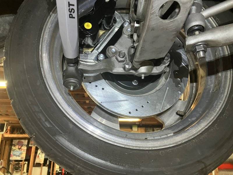

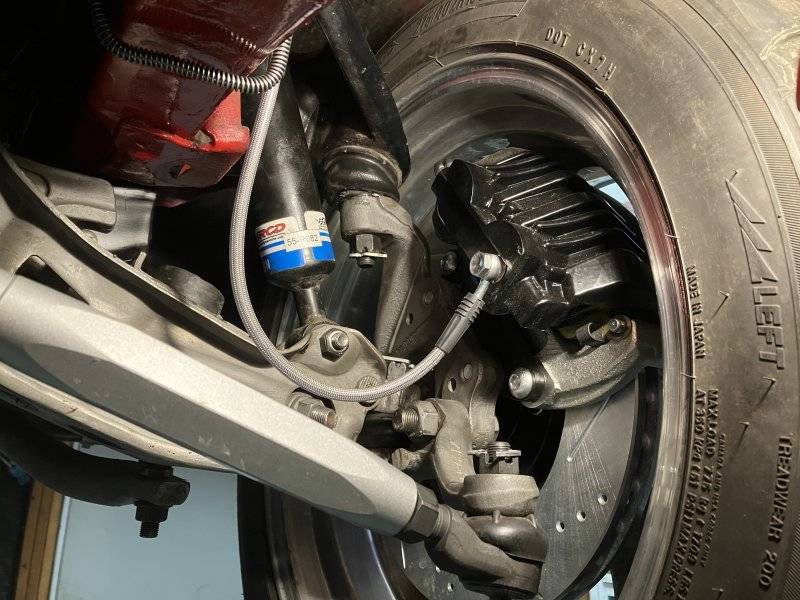

I have 18 x 9" front wheels with 4 1/2" of back spacing as shown here:
Outer tie rod clearance is not even the slightest issue with wheels this big.
Using Greg's photos, picture the wheel/tire/rotor 2" higher and you can see where the interference can happen at the tie rods. The reason I inquired about the drop units was if I pick up a wagon w/o d/b and want to do the swap, I already have a pair of the F/M/J units available in my stash, for my 65 which completion date is a couple of years away and I would get the drops for the 65. But getting feedback about geometry problems, I plan on doing track events with the 65, then seeing those pictures with the wide wheels, will be doing similar, shoots that plan dead. Nice to get feedback from those in the know so I don't waste money. I remember there was mention in Andy F's book about this, plus an article or two elsewhere, which refreshes my memory of what not to do.
