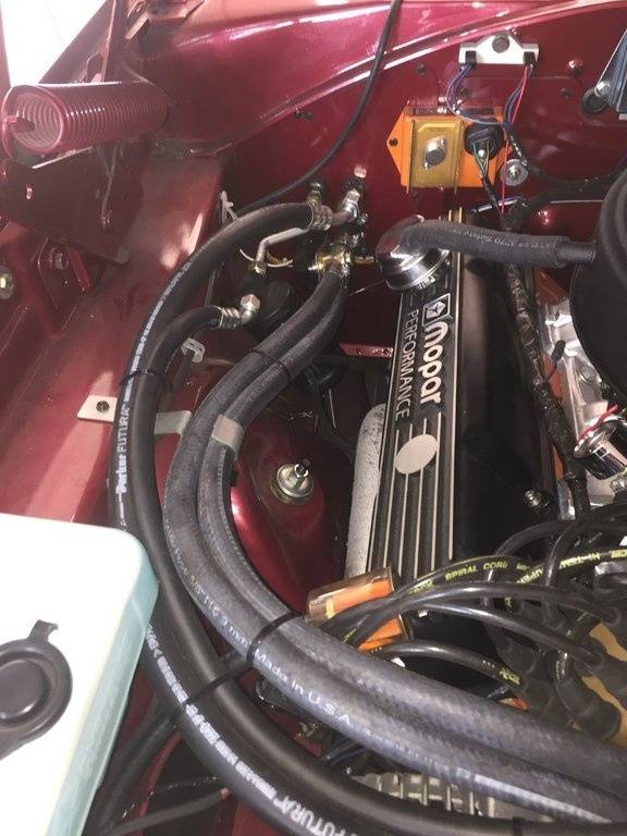

I have the same system in my '69. Works great and lets me drive it on days I'd normally leave it at home.

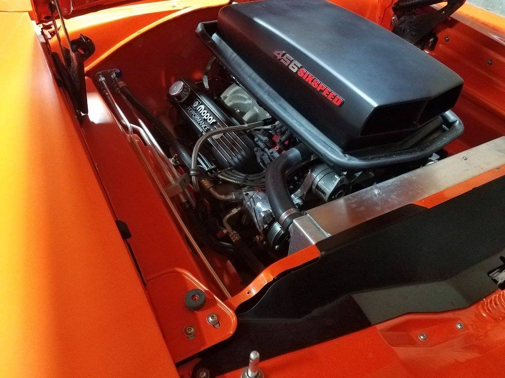

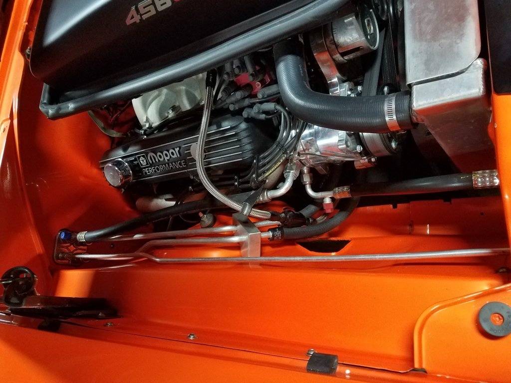

I have Vintage Air, 32 degrees coming out of the vents:thumbsup:. You'll get good feedback about both the Classic auto air and Vintage Air, my suggestion is to just look over the different components and find what you like. Mine is servo operated with everything being concealable which was my goal. Also pump mounting was the other big consideration but I went serpentine with a passenger side low mount, really like how much it cleans up the plumbing being where it should be.

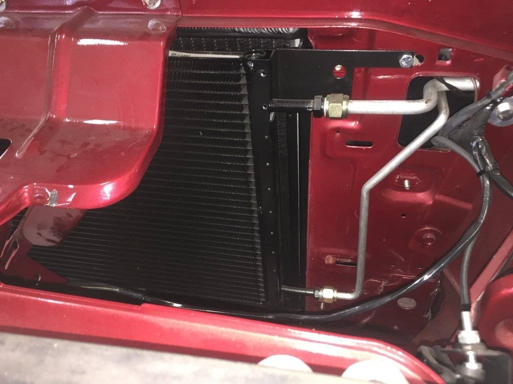

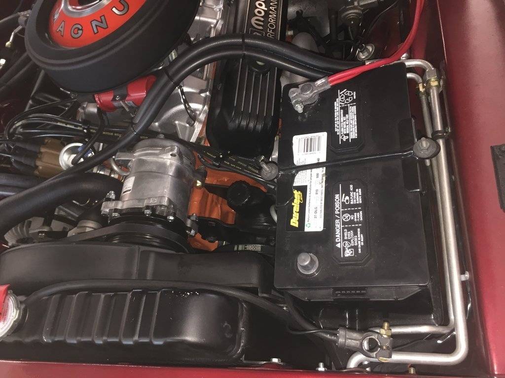

Classic Auto Air here. 10 years. Ice cold. Never a recharge or hiccup. They were in Tampa then on Kennedy Blvd. I have seen 29 at the vent. Distribution has improved since my purchase. Mine uses the existing cable controls, newer reported to have better control box. Would not be without it. Reno, Vegas can get pretty hot.
No issues with the install. I did mine when the dash and motor were out so it was far easier but after doing that I wouldn't be afraid to do one with everything in the way. The mounting bracket didn't line up well but that was an easy mod. Makes it look busy but it does work great.
WOW!! Thanks everybody. I appreciate your pics and help. Your installation looks really great, 747mopar. It looks smooth and clean. As I am building a restomod, that´s exactly what I want...

I ordered everything from Summit Racing but no kit, just picked out everything as I went. I mounted the evaporator, pump and condenser before ordering any plumbing. The aluminum tubes are also Vintage Air bought from Summit Racing as well. For the hoses I bought the ends and bare hose, fitted them to the car then took them to a local shop to be crimped. The serpentine kit is from SD Concepts and to me the most important aspect of keeping it clean with the pump being low and already on the passenger side.

Could you send more pics if the serpentine?

I'm sure it does rob power but with a big block I don't notice it however at idle it will pull the rpm's down a fuzz. I might eventually add a fast idle solenoid to the carb to address this. Really the only reason to even address it is it must pull the rpm's just low enough that my alternator doesn't charge as well..... bump the rpm's up by 100 rpm's with the pedal and it jumps right back up to 14V.
