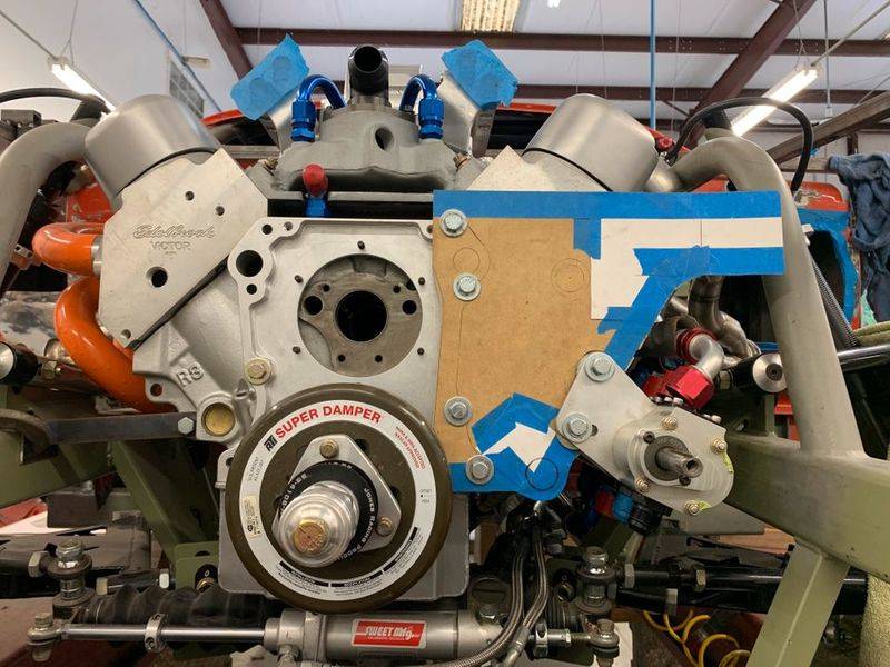

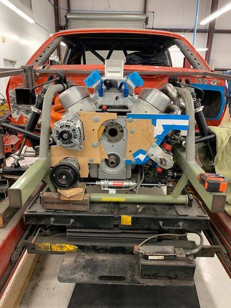

I had always planned to run a motor plate on my car. When I got my Jesel belt drive and saw how much of the belt was exposed, I figured why not make a plate that would also enclose the timing belt. If I was enclosing the belt, this would also give me a place to mount the cam sensor. So I started templating accessory locations. Went through many paper templates trying to figure out what fit where, does it have enough clearance, etc...
The layout really came down to what fit where, with enough clearance. I then made some wood templates so I could actually hang the accessories. This took a few tries as well to find out where everyone was happy.

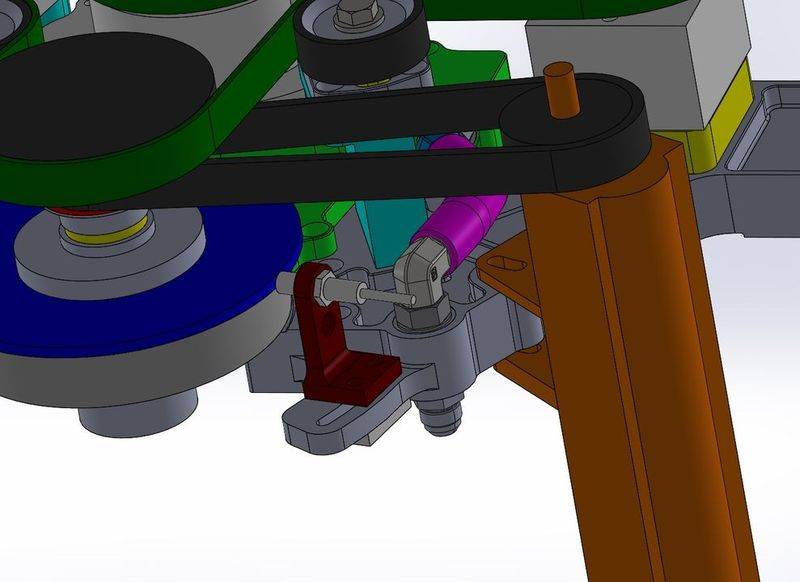

I then moved to measuring all the accessories. Huge PITA. Used a surface plate and height mic, but allowed everything to get transferred into Solid Works:
It was coming together, but still not happy with belt wrap, so more tweaks were needed. Ended up adding 4 idlers and a mechanical tensioner to achieve proper belt wrap and length.
Also wanted to incorporate the crank sensor bracket.

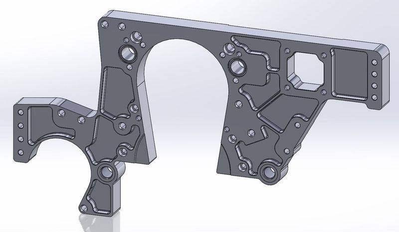

Performed some lightening on the plate and then ran some FEA test.
Made a few modifications that affected weight very little but increased strength 35%.

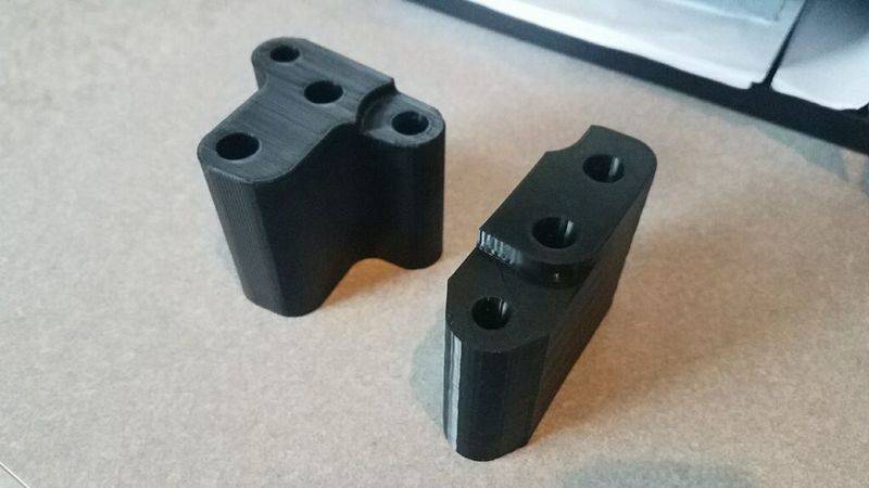

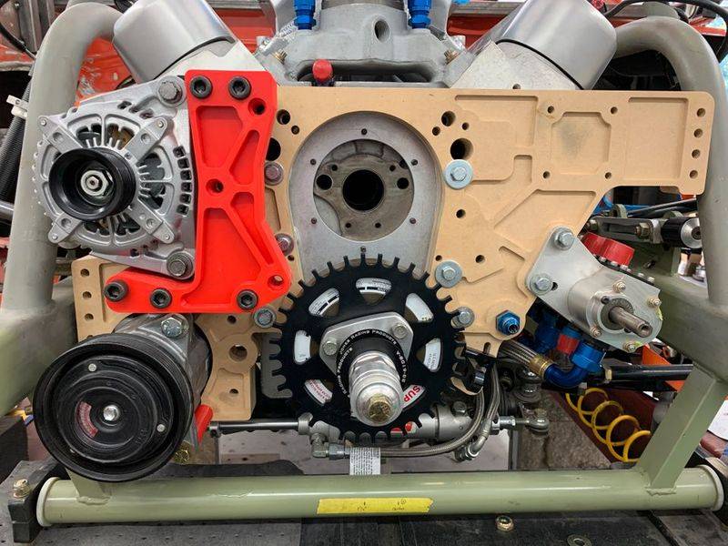

I had the motor plate CNC routered, and the brackets 3D printed.
And bolt it up. Glad I did this extra step, a few small tweaks and it's ready to machine:
