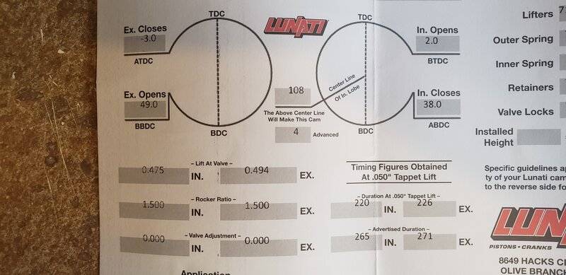

Depending on how that goes...my plans include: heads go on a shelf. My new to me Eddie RPM heads go for a cleanup at the machine shop, and lite cut to bring the 84cc chambers down a little. Cometic MLS .027 gasket, voodoo hydraulic 702 ([email protected], .474/.495E in at 8degrees), 1.6 rockers (prolly new pushrods), Eddie RPM manifold, 770 AVS2.
Thoughts? I already have the cam/lifters/rockers/heads/carb/headers

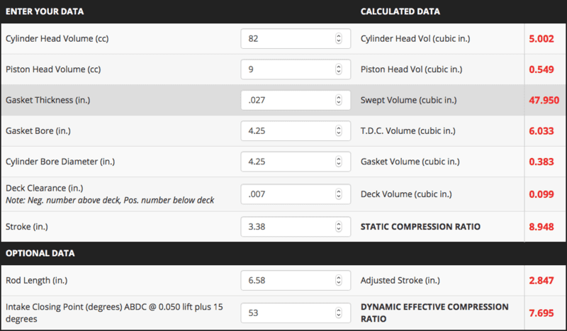

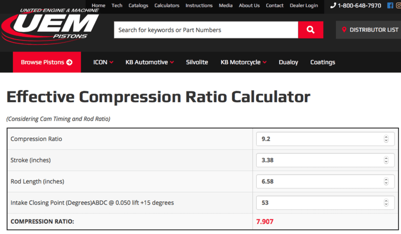

Wallace appears to have missed a step... Every other Dynamic calculator has you add 15 degrees to your closing point...

I was playing with this calculator the other day, what is the point of adding the 15°?
In cams there is typically the advertised duration & the @.050 duration, the advertised duration includes the opening & closing ramps, the ramps are very mild lead in ramps that eat allot of duration without producing much lift (.050) These ramps don't produce much flow especially when trying to draw air into the cylinder... But the intake closes as the piston is starting to reverse direction & come up the bore... so until the valve is closed the cylinder won't build pressure... Well now the ramp will bleed pressure till it's closed so you have to allow for that..
