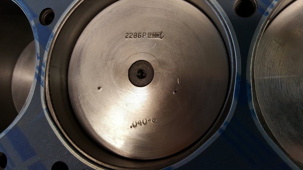

bore size help!!!
You can prob go with just about any head gasket there. You just don't want the gasket to hang into the cyl bore. Cometics may be one of the best, but with a garden variety 361, I wouldn't waste money on anything fancy. Also, those gaskets require a very smooth deck surface to seal, as I understand. So you should resurface the block and heads before assembly to insure a good seal. The steel shim at .020" thick will get you some needed compression, seal well, and they are inexpensive. What heads are you using?
They're just my stock heads cleaned up with new valves and seats.
I'm .040 over on my 440. Used Felpro 8519pt1 measured fine on head and cylinder clearance.
I think that is what is in it now. Which ever felpro comes with the gasket kit. I may go with them again as everyone says they do just fine. I'm hoping maybe they just weren't torqued properly and I don't have something more serious going on.
