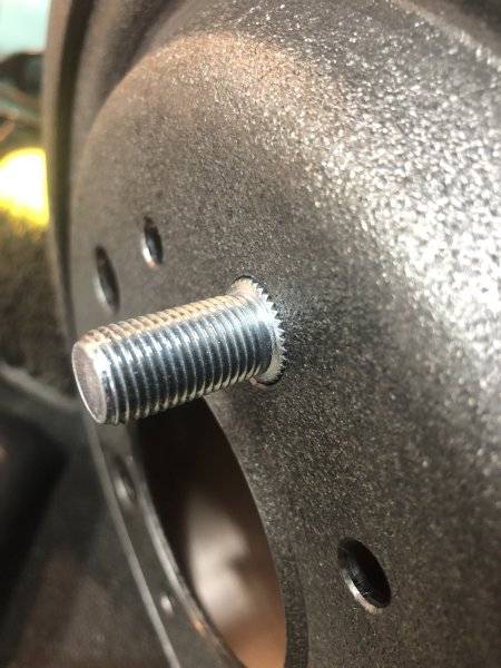

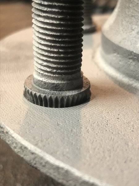

I am in the process of replacing my front brake drums and hubs and I found that my drums don’t slide all the way onto the hub. I can wiggle the hub back and forth when it is lined up on the drum. The knurling on the lug studs is slightly cone shaped towards the end of the knurling and is keeping the drum from sitting on the hub all the way. Is there any way to remove these studs without damaging the hub? If possible, I’d prefer to have slip on drums and not have the hub/drum stuck together. Is there any way to do this? I have already bought new studs that are for my year car. Will the new studs allow me to just have the drum slide on and off? The new studs I bought appear to be the same length from eyeballing it. The new studs also fit inside the drum with very little movement. I have a “66 Coronet, 10” powered drums. Any help is greatly appreciated.

Those stud look like rear axle studs. No splines should be sticking out. Correct ones would have a smooth section for swaging. What do old studs look like, compare them.

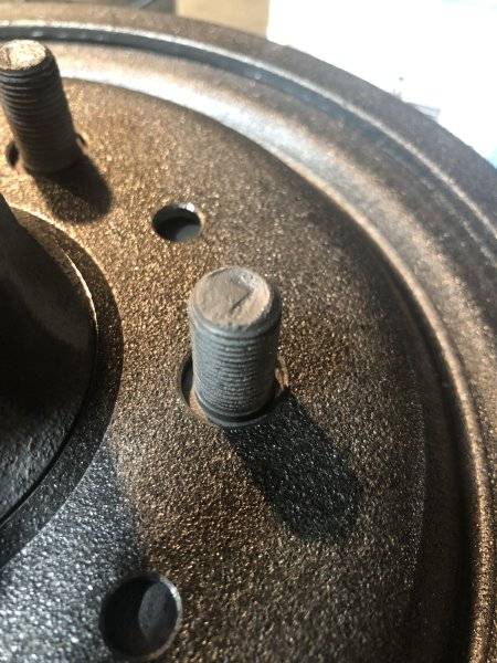

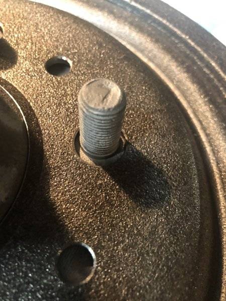

Those studs have already been swaged out, and were just forced out thru the old drums. Gonna need new studs.
You might try grinding some of the spline off so the drums will seat on the hubs. That worked for me on one of cars

Studs seem like the wrong ones to me.
These are the Dorman 610-132 studs on 11” drums for my 68 roadrunner. Hope this helps
And you know this for a fact? Have you used them? Ive run through like 5 different studs and nothing is working for me yet. I havent tried these yet, youre sure theyre not too short? The stud holes in my hub measure .630, these say .650. Is that too different. This has been stressing me out.
I used them on my 67 Coronet with 11 inch front drums and they fit correct. 610-122 says it also fits 66 Coronet with 10" front drums. I also have a 66 Coronet but haven't changed studs to i can't tell you for sure. Looks like napa sells them. Might be worth buying 1 and see if it fits.
