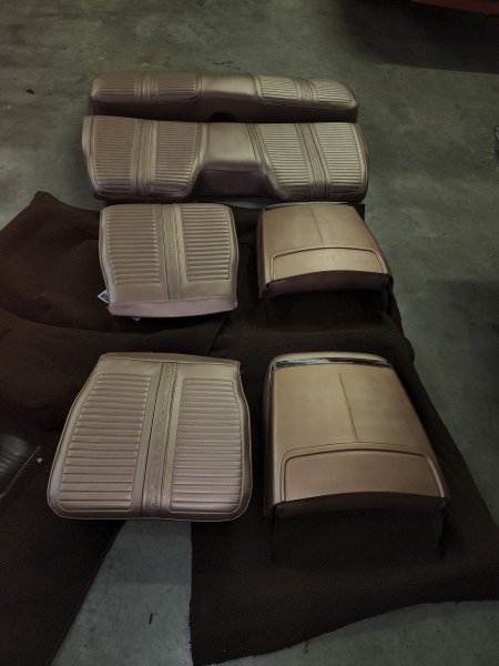

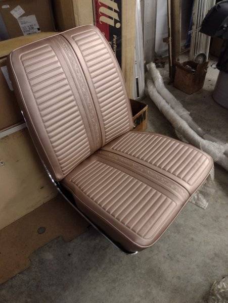

I got the foam from Legendary for my current restoration. I didn't look at it, I just took the covers and foam to the upholstery guy. He didn't mention any problems.

same foam just cut it .Legendary Auto Interiors has a video on their website on how to install foam and covers on 67 Plymouth B bodys
Thanks. Good to know about the video.
Jerry, those look nice. I think the last guys that did covers on mine cinched the center listing wires directly to the seat springs which pulled the center down to far. Yours look more correct and I’ll probably substitute heavy cotton upholster thread for hog rings for those center panels to avoid pulling down too far. But I’ll look at the video first.
