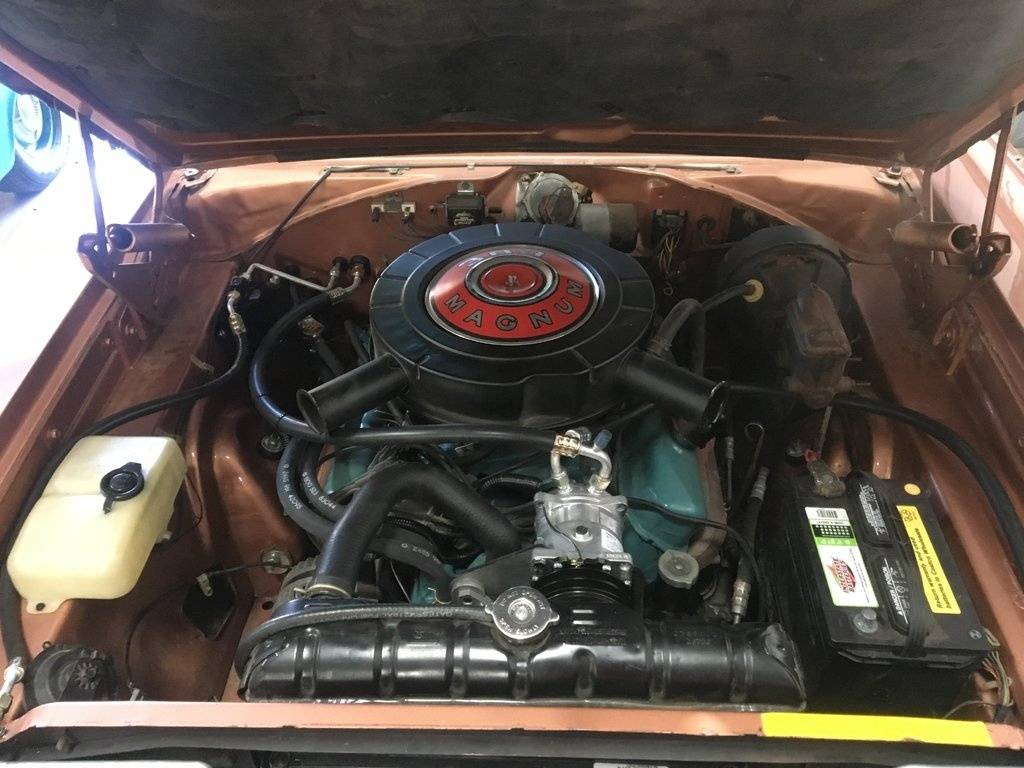

Factory 67 383 4 barrel car original engine so did the following:
438 source kit with Arp2000 rod bolt upgrade lol
516 heads with big exhaust valve.
272 mopar cam.
2.94 one leg this thing cruises and will melt the one tire anywhere anytime lol.
Hidden Petronix conversion as well.
