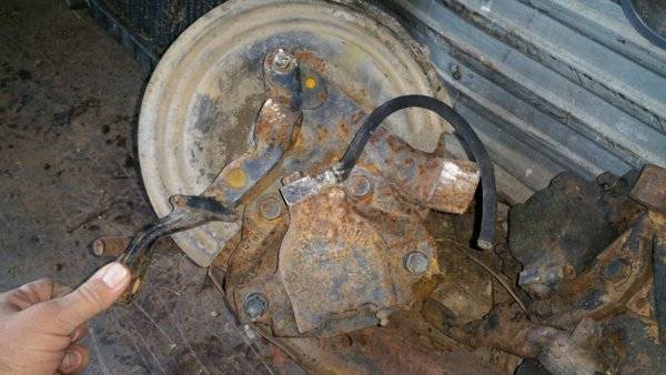

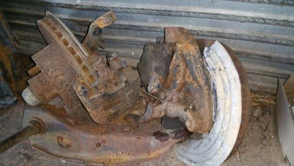

Assuming you're versed in classic mopars, do these look like a b body set up? I have had them stored away for years and don't remember what they were pulled off of. Thanks,

The Cbody spindles and associated parts are not suitable for an Abody or Bbody however the 1973 Cbody spindles and associated parts are HIGHLY sought by the early Cbody folk for their swaps.
I cant tell from the pictures of the brakes what you have there however if you measure the caliper adapter mounting bolt distance apart and its smaller than the Cbody caliper mounting bolt distance apart, they will most likely be from a 73+ BBody (73-75 as its the pin type brakes and steering arm is not an integrated ball joint as Abodys are)

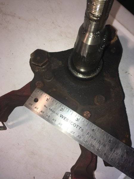

oh sorry I didn't get a chance to do this last night...
The caliper adapter mounting is 3 1/4" between bolts and is the same for all A, B, E, F, M, J and Rbodies from 73 to 89 regardless of the 10.89 or 11.75 disks or pin vs slider
I don't have a 73 Cbody set to take a picture of or measure at the moment but I know the bolt distance is larger but don't know by how much
