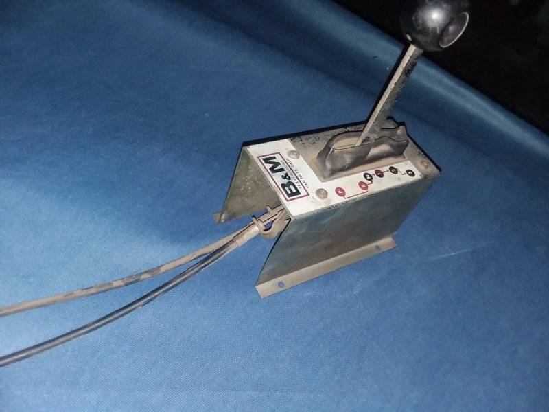

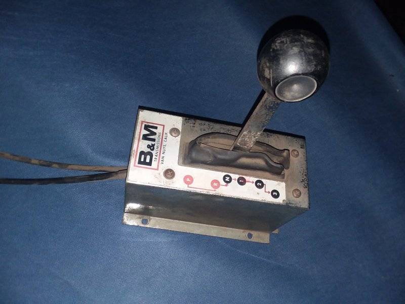

Are you talking about a pushbutton trans? If so, it won't work. The pb trans uses two cables, one specially for park.
B&M made a chrome box aftermarket lever shifter for a pb trans, but they quit making them at least 40 years ago.
This one is mine. It only works with a rmvb.
