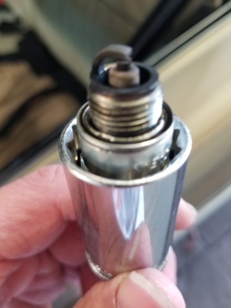

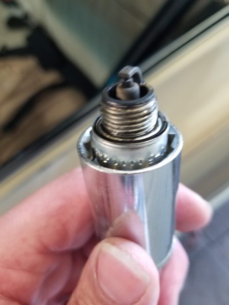

read the plugs, could be ignition timing aiding to it'

What heat range are the spark plugs?

reading the plugs
do 1 thing at a time
can give you a good inclination what's going on, which way to go next
some ignition timing may help too
an extended tip plug, may help too, get the spark deeper into the void
(if you have room, it's a street car I'd assume it's not max compression)
& a NGK 6 is pretty hot already (bigger # colder on NGKs, like 7,8,9 are colder)
it' all depends on what's going on in the combustion chamber
read the plugs refer to the meme I posted, it works
