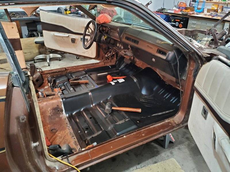

Hello all, looking for input on carpet for the 72 charger. I'm finishing up the floor pan install and will be shopping for carpet.
Do most use the loop carpet? mass backing or no?
Asking what everyone uses and places to get it. I have found many places on line and most are similar in price.
Rock auto even.
Thanks

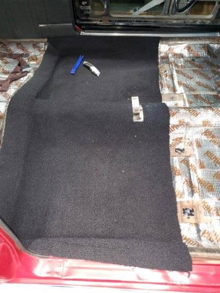

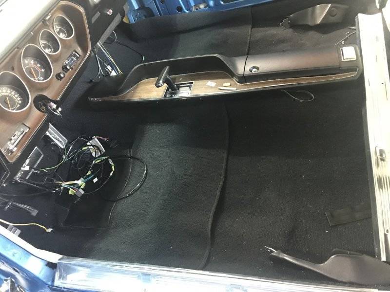

I used mass back ACC last car I put carpet in, a '70 Challenger. The rubber or whatever material backing they use was molded perfectly for the floorpan. It was more work to cut and trim. I should have wore gloves as I ended up with blisters on my hands, but in the end it was worth the pain and suffering!
I got mine from Rock Auto where I found the best price, and used one of their 5% codes. When it arrived I took it out of the box immediately and laid it out on the floor so it would would be flat with no creases or bends. I think most of their orders are made to order and drop shipped, so it probably had been rolled up less than a week when I got it.

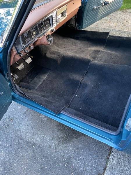

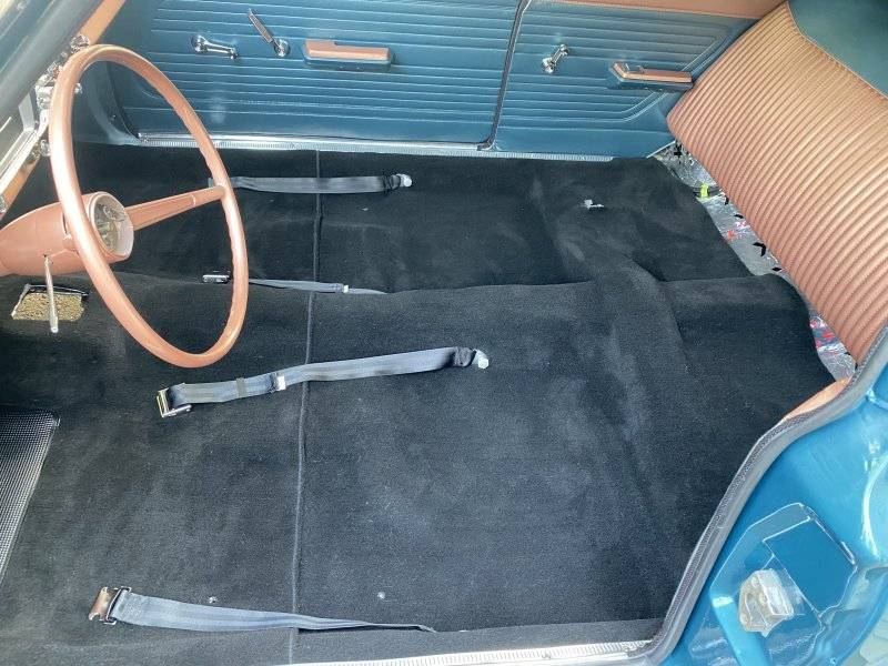

Another vote mass backed ACC. Installed it in my ‘65 Belvedere this summer. Molded areas fit really nice. Trimming it was not difficult- used a good (new) pair of tin snips.

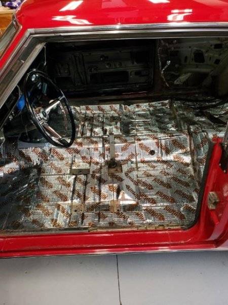

If you are using a sound deadener like kilmat, hush mat, don't get the mass backing. Order it without. Refer to post #6 on where to buy.

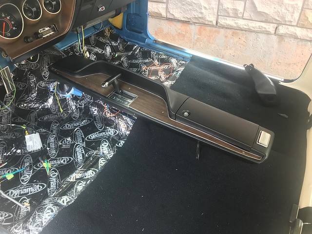

I did ACC also, '67 GTX.
Took it out of the box when I got it and laid all of it flat in the garage for 2 weeks.
This also helps get rid of the smell of the carpet, it's pretty strong when you get it, but goes away.
I installed it last summer here in CA, the weather was hot and the carpet liked it.
I did Kilmat in the whole car and carpet with no backing.
No tape or glue or anything, and the molding, trim pieces, seats, seat belts and center console holds it all down solid.
It was just the usual trimming here and there, cutting around mounting brackets, holes for seat belts and other things.
Took my time with a few beers and the fit was really good.
Good luck.
