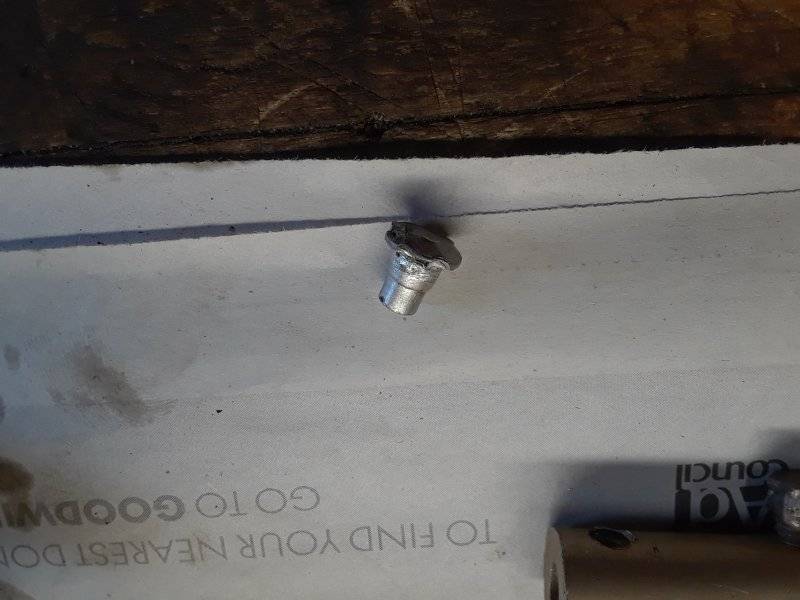

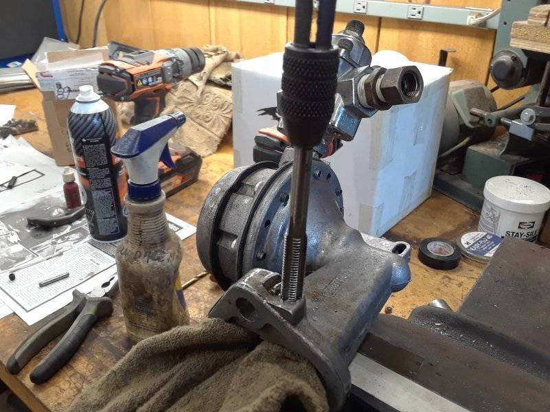

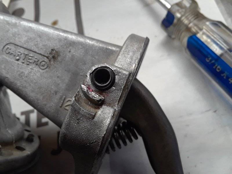

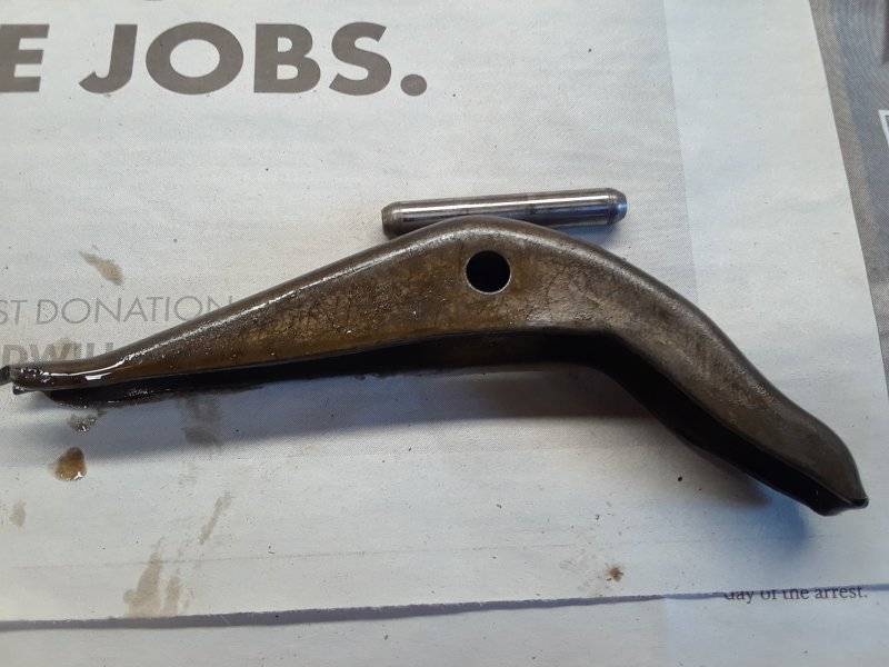

Rebuilt 2 Carter pumps using their kits. Quality parts and knowledgeable at the other end of the phone. One note - instead of peening the pin that holds the pump "finger" in place, I would tap and thread and install a set screw. Ask me why I did this.
Ok, I’ll bite, why?
The plug that is peened in to hold the pin feel out - hence a $150 tow call.
