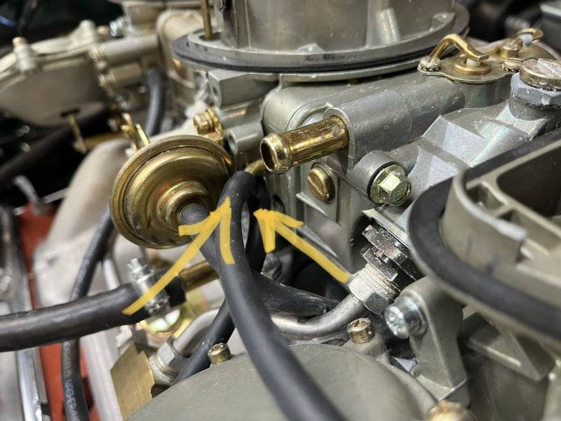

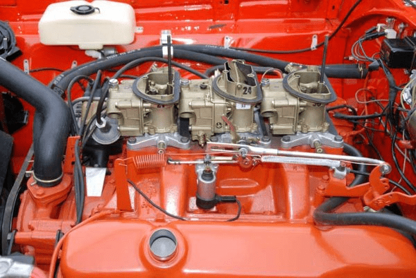

Yes , are you using the solenoid on the 6 pack? My 2 setups I never used the solenoid.
RPM builds the vacuum I believe
Yes , are you using the solenoid on the 6 pack? My 2 setups I never used the solenoid. View attachment 1368756 View attachment 1368757

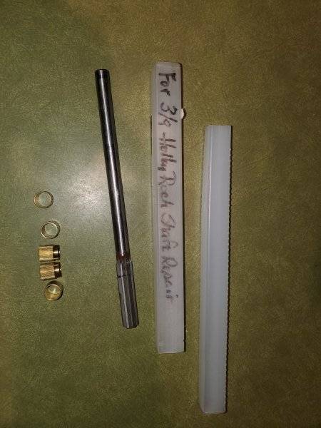

If there is leaking around the throttle shaft, that needs fixed. Mine was misshapen causing a vacuum leak that took forever to figure out. I bought a kit off ebay. It comes with the reamer and new bushings. There's several videos on YouTube about how to do it with a regular drill. No need for a drill press. I was worried about doing it myself, but it was easy. They're brass.
Super information! I bought the bushings already. Did you have high idle issues resulting from the vacuum leak?
I was having severe tuning issues, not just idle. My idle was all over the place. Sometimes would be high, then low. It was also creating adjustment issues. The throttle shaft hole was wollered out to where sometimes the shaft would sit just right to seal up.
It wasn't me that found it. I took it to a shop and they ended up finding it. Said to take the carb to a machine shop. After looking into it, I saw that I could do it myself for a few dollars.
Couple years later and it seems to be doing good.
