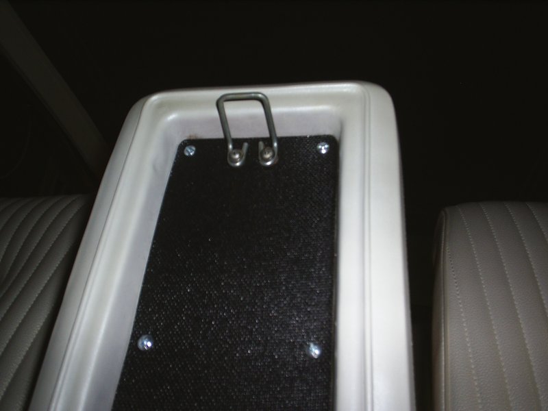

Good Afternoon everyone,
In my new (to me) 66 Charger the button to open the console is missing. Does anyone know how to get it open with the button gone?

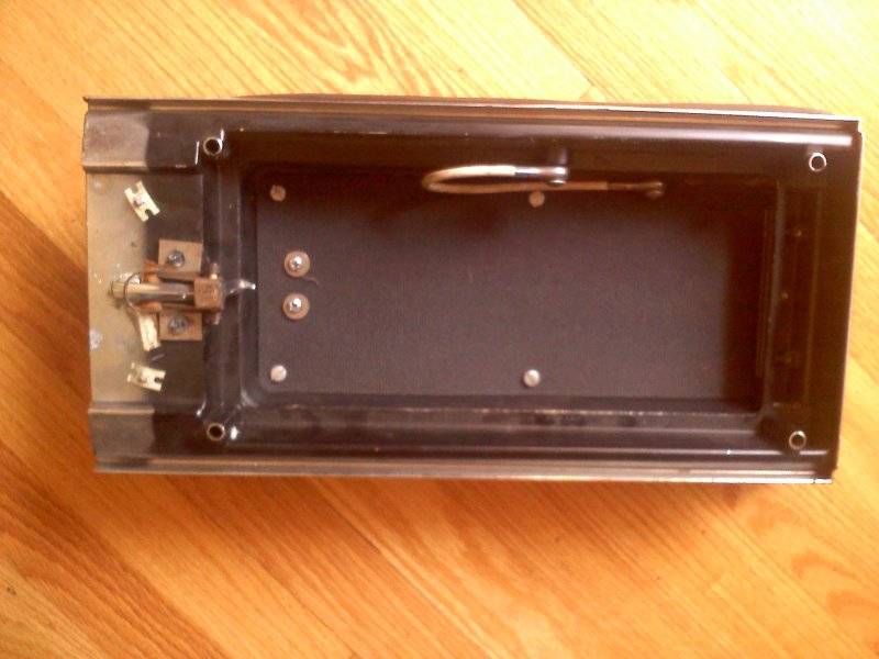

If you put something like a punch, screw driver that fits in the hole and push down you should release the spring and it will want to open. Once in awhile you might have to hold the lid down until it wants to pop up. Let us know if you get it open.

You had it when I got home I looked into the hole and theres a lever I pushed on it with a screw and Wallah! It’s Open. Thanks

That is what I was hoping, part of being a member. You might be able to find a door lock knob put it in upside down and use that. Not OEM but works.
Hold the lever down/open and slide the knob up from the bottom. The lever will hold it in place. Also a Clevis pin can be made to work.
Possible to make something that will work with a little inventiveness like what 440 4 speed dude said.
No lock, just a button if I understand your question.
