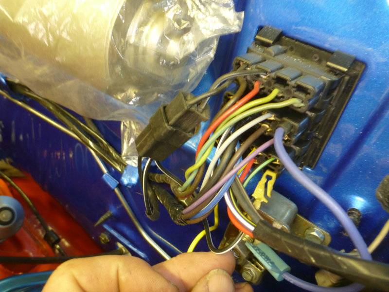

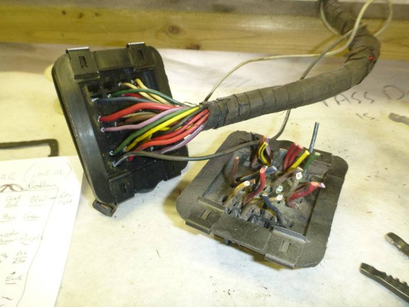

were does the 4spd reverse light plug into?
'Z' in the bulkhead connector.
so feed the wire to that spot?
Gave Dave pictures.. but here they are for anyone else working through this later. Jumper from trans switch wires to the lower drivers side (Z) location on the bulkhead and the single added in black/w wire inside from the mating location to the dash light.
dadsbee thank you for helping me. Once again this site is a blessing.
