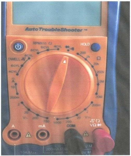

This question is on my 2028 Lincoln MKX not my '68 Road Runner.
Can I use the multi meter (attached) to check for a drain on my battery when the car is turned off?
If so, some instructions on setting on the meter and procedures......
Any help would be greatly appreciated.
Thanks,
Frank
You would use the A setting. Id probably start with the 10 setting black in common position red in A position . You will need to place it inline with the suspected drain. Say you think its instrument cluster, remove that fuse and instert red lead one side of fuse holder and black lead in the other side. Newer cars have circuits that draw current for up to 30 mins after ignition off and doors closed. Some may even have continuous draw. Best of luck.
