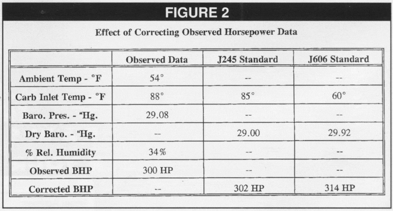

This is, of course, a dilemma for anyone conducting an engine develop-ment program. How can you compare data between dyno power runs when the atmospheric conditions are different, day to day, run to run? Engine guys solved this years ago. They adjust or “correct” the observed power data to a “standard” barometric pressure and temperature. Since humidity also has an effect, an adjustment is made for that too. This corrected power data can then be compared with reasonable assur-ance that the difference between power runs was due to something other than the atmospheric changes. The SAE rating codes specify a “standard” to be used. Before 1972, everyone used the J606 standard. The J245 standard of 1972 gave a lower corrected HP. The J1349 standard, now in use, will give a corrected power about halfway between the older codes.
The dyno data that you get from your local dyno shop will more than likely be corrected. I called Superf low, who is a major dyno producer, and asked what standard their customers use. The guy I talked to said that most use the J606 standard because, and I quote, “it gives more horsepower.” Just because your engine was dyno’ed at 300 HP doesn’t mean it’s making that much on any given day, though. Remember, the atmospheric conditions are constantly changing and your engines “observed” BHP, which is what makes your car go on any given day, changes with the conditions. That’s why it runs better on a cold, clear day.
Let’s see what effect this correcting process has. I put a thermocouple at the air cleaner on my D-150 the other day and measured the temperature of the air going into it, at a steady 65 MPH. Also, I checked the barometer and humidity at the local weather station. The data are shown in Figure 2, along with the SAE J245 and J606 standards. Now, let’s assume that the “Observed Net” BHP of the engine was 300 HP that day. Using this data, we find that the engine was making 302 or 314 “Corrected Net” BHP, depending on which standard is used. Notice that the pre-1972, J606 standard, does give a much higher “corrected” HP! No wonder the dyno shops like it!

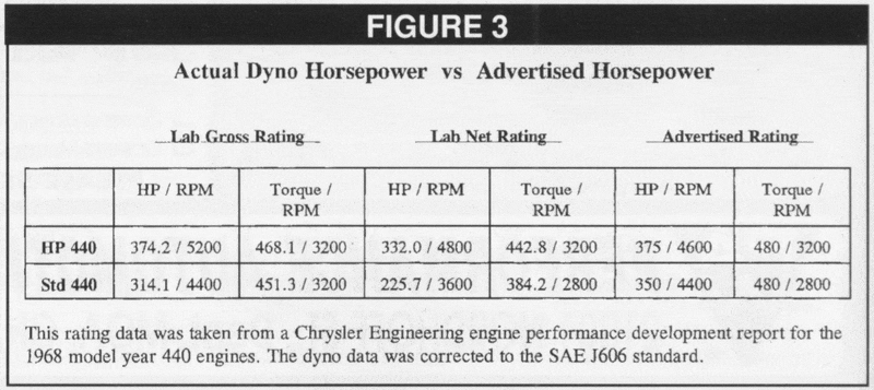

I recently came across a copy of an engine performance development report for the 1968 440 engines. In the report are the Lab Gross and Net ratings on the engines, using the J606 standard for correcting the data. Before we go any further, we have to understand that before 1972 (and to a certain extent afterward) horsepower ratings were a marketing thing. During the horsepower wars of the ’50s and ’60s, big HP numbers sold cars. Us dyno guys would do “rating runs” and send the results to the marketing guys. They would then decide what the advertised rating should be, based partly on the results and partly on marketing strategies. The Feds wised up to this, and mandated the use of the SAE Net HP rating for 1972, which, assuming no one cheated much, made comparing horsepower between vehicles actually meaningful.
Now, let’s look at Figure 3. Notice that the peak HP number for the Magnum (HP 440) under Lab Gross conditions pretty much matches the advertised number, but the peak torque is lower. Although the report does not show results under the Cold Bare Gross configuration, I can assure you that blocking the heat crossover will increase the peak torque at least 15-20 lb-ft (as well as increase peak power by 8-10 HP, assuming the jetting is right). So, the Magnum can match its advertised rating, if run (and corrected) under the right conditions.
Yeah, but how much power did the engine in your GTX make when you picked it up from the dealer? Well then, since the Lab Net rating is with the engine “fully equipped,” like it’s installed in a vehicle, then it must have been 332 HP, right? Well...there are a couple of things I forgot to tell you. When we did rating iuns, we always used a “good” engine. The engines we used for dyno development were usually production engines. We would give them a 13 1/2 hour break-in before we used them. After maybe 1500 hours of dyno time, an engine would loosen up to the point that it would produce maybe five or ten more horsepower than the other 440s we were running. Unfortunately, once it became “good,” it wouldn’t last very long. The crank would break. If we had a “good” engine and knew that we would be doing rating runs soon, we’d remove it from the dyno and save it for that purpose. Another thing we did was mill the heads to bring the compression ratio up to the advertised value. Production engines were typically a half-ratio low. Also, the valves and seats were touched up, just before the ratings started. Did we cheat? Well, it was still stock, right?
So, since your GTX didn’t have a “good” engine in it and it was a half-point low on compression, then it didn’t make 332 HP. Maybe more like 310-320 “Corrected (J606 standard) Net “ BHP. Of course, the “actual” HP or “Observed Net” BHP would have been more or less than this, based on temperature and pressure. Probably less. There’s not much difference in the pressure and humidity between the outside ambient air and the air going into the air cleaner. But, the temperature can be quite a bit different. Notice in Figure 2 that my truck heated the outside air from 54ºF to 88ºF, that’s a 34 degree increase, enough to reduce the observed BHP by about 14 HP. And this was in a breezy truck engine compartment. In a tighter engine compartment, like on a GTX, the air would be heated even more, further reducing the observed BHP, unless of course, the Air Grabber is open. The real bottom line, though, is that the state of tune and internal condition of your engine, the atmospheric conditions, and the amount of heat the air picks up before it finds its way into the carburetor, all combine to cause the actual “observed” HP on any given day!
