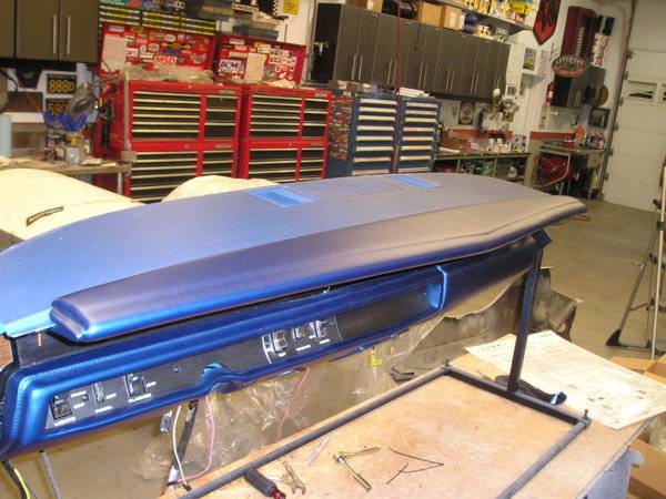

Textured powder coating works well in black. The dash i just finished up was powder coating in a funky blue (for the texture) and topcoated with an Axalta interior paint.

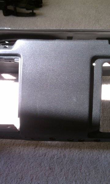

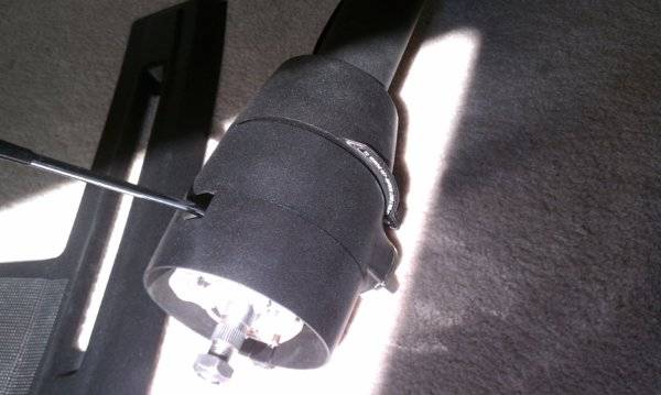

I was thrilled with the Duracryl Lacquer was available from Instrument Specialties. If you have a painter that still knows how to spray acrylic lacquer, then its a great way to go. I did my dash and steering column in this original paint and my body shop painter was able to get it to dry with that original texture. Lacquer is temperature and humidity sensitive so I can dry to quickly and become whats called "hairy", meaning it will have a real rough texture like 40 grit sand paper, but if it dries properly you get the fine texture. Plus that paint has tiny silver flake in it which gives it a nice glow. Here is a picture of the center of my dash, in the sunlight so you can see both.

One was enough to do my dash and column plus glove box and ash tray doors and speaker cover on top of the dash, with just a little bit left over.
