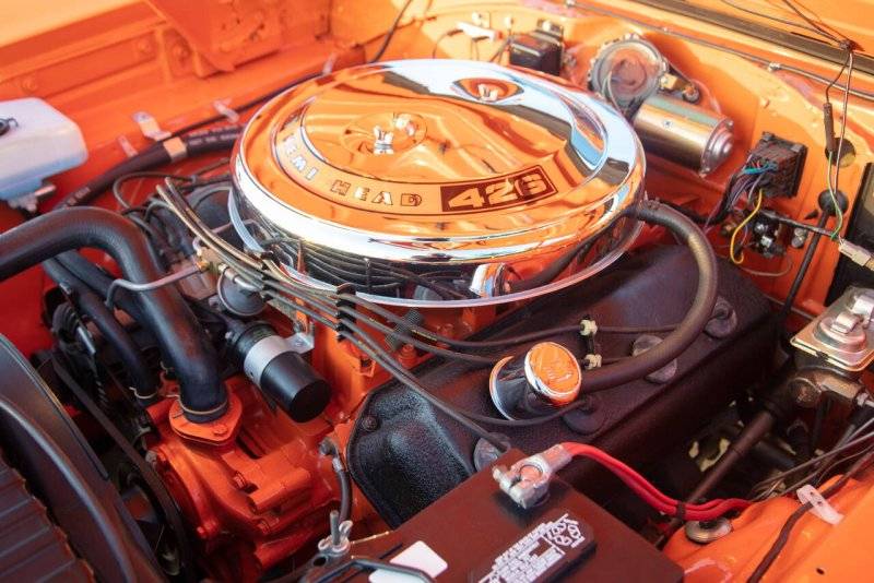

I need your help,
I have repro black wrinkle steel Valve Covers from Mancini Racing (68/69 style) with 1.5“ hole tube for breather. Right side (passenger) will with PCV Valve connecting to carb and other side right (driver) should breather with tube nipple for connecting to air cleaner.
At AMD has repro push in breather with tube nipple, but it has 1.25“ dia (maybe failure). Or maybe had anyone install that same breather and can tell me, it work well with 1.5“ tube hole…
Link to repro breather
Oil Filler Breather Cap - Tall w/ 1 Hose Outlet - Chrome - 68-69 Mopar Oil Filler Caps | AMD 337-1068-C
Bought my breather from Tony Diagstino
Mine is oem valve covers and air cleaner
Tony's Parts com
