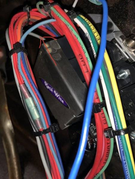

Oh, one more thing. There’s this light that I don’t know what it’s for. It’s on when the key is, even just hanging there. Seems to be grounded by the second wire.

That light with the two black wires, one goes to ground and the other becomes a grey wire that goes into the side of the Quik Wire box. What would that be for?

Thanks but I don’t think so. I have no switch on the emergency brake pedal for that. And this light comes on with the switch.
Your E brake would have a switch from the factory. I still believe that two black wire lamp is for the E brake switch.
@70gtx440dana Ya I realize it would have the switch from the factory but whoever restored the car didn't put one in. I maybe should try to find one some day.
