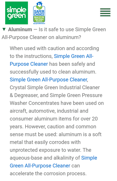

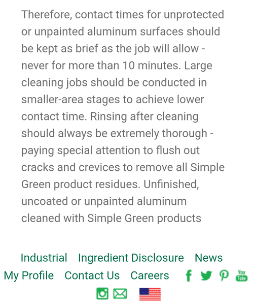

Since you mentioned aluminum...
https://simplegreen.com/faqs/
