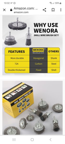

Without seeing photos of the brushes the op is talking about, the RPM range of the ones I am thinking about is not very fast. Let me see if I can find a photo and description.
Here's some that are rated for 4500 rpm. A die grinder would be suicide.
The ones I linked above are rated a little higher.... The lowest RPM ones are 20,000.....
