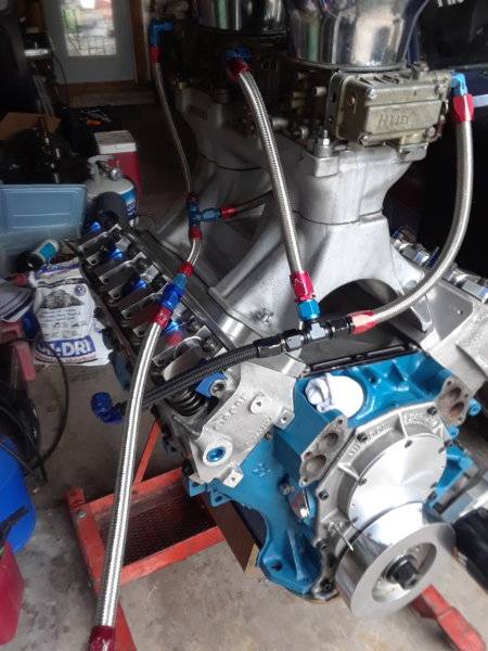

My 512 build is in the car, and the truck 400 block I'm using has a factory plug in the dipstick hole. The truck motors used an oil pan mounted dip stick. So I need to remove the plug! Any idea how to do that? It seems to be pushed in there pretty tightly, with only a small lip at the top. Not much to grab onto. Not alot of room to work, either. I Should have pushed it out when I was building the motor, but didn't even think of it. Help!

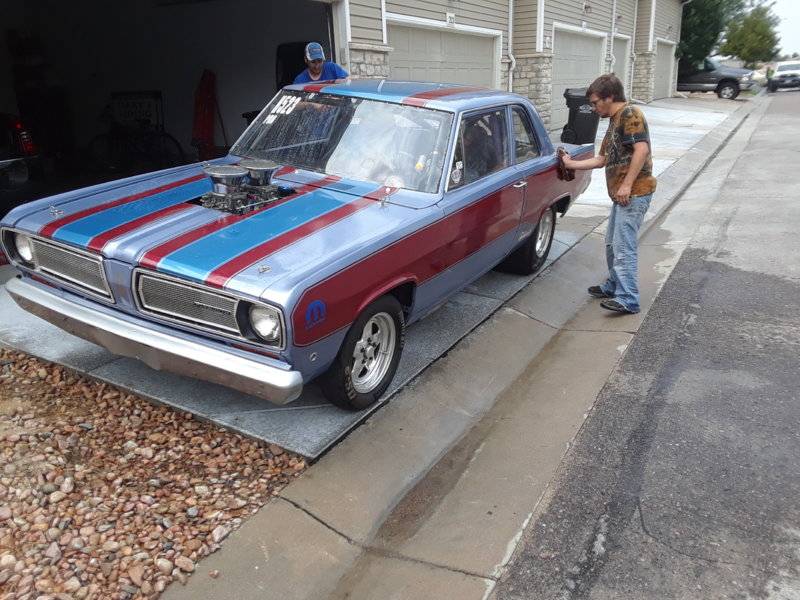

What hood scoop are you useing :lol:
We just
cut a bigger hole in the hood. This was with the 496 in it. Using same intake and carbs.

I'll try and post a pic tomorrow. Looks like it is flat acrosd the top, and has a small lip on it.
