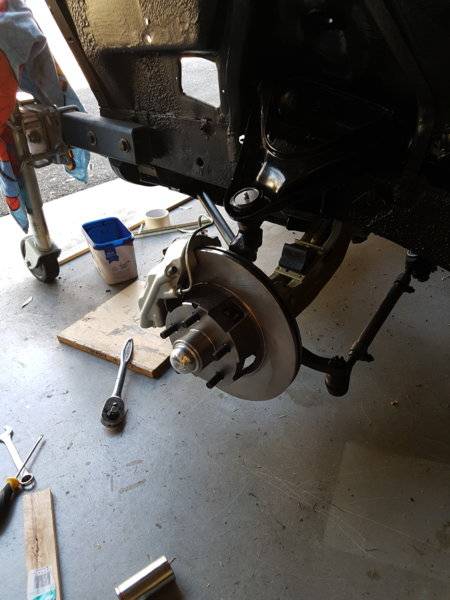

I used the Dr Diff kit. Manual with 15/16 master cylinder. So far, I'm happy with the results.
Hey Bill,... which DrDiff kit did you use? the 10.95 or the 11.75"?
I wanted to keep the original wheels so went with the 10.95.
