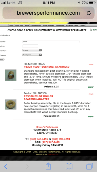

Here is another option from brewers performance.

I use the roller bearing and eliminate the pilot bushing. It is a sweet set up...

Have you ever had problems with the roller type?

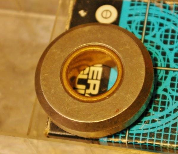

I bought this one (in photo) several years ago for a project but ended up not using it.
