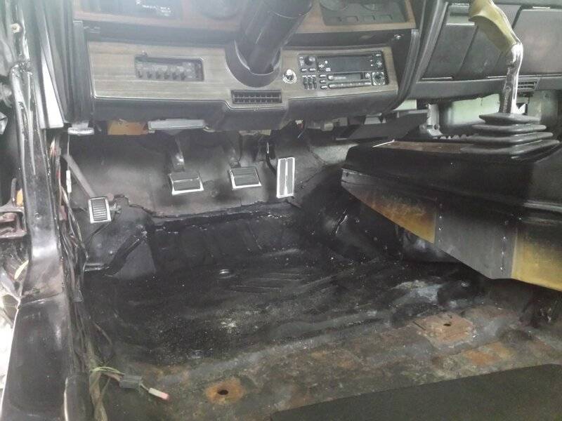

My 78 magnum had rot at both front footwells. I used a reproduction floor pan from a third generation b body charger and cut out the parts I needed. I fits, but the stamping is slightly different. The back half of the floor pan is very different. Luckily I found a full floor pan on Craigslist pretty cheap.

My 78 magnum had rot at both front footwells. I used a reproduction floor pan from a third generation b body charger and cut out the parts I needed. I fits, but the stamping is slightly different. The back half of the floor pan is very different. Luckily I found a full floor pan on Craigslist pretty cheap.View attachment 1121327
What pedals did you use for the manual conversion?

The floor pan I used was very different from the rear of the bucket seat bolt holes rearward. I would have used more of the pan if it matched better. But it didn't. Luckily my rear pans on had little spots of rust here and there that was easily fixed. And I have no clue about the trunk sheet metal.
I used another brake pedal from a 76 cordoba and modified it. The brake pedal pads are from a dodge caravan and the stainless steel dress up bezels are modified from some worn out automatic bezels I had lying around.
