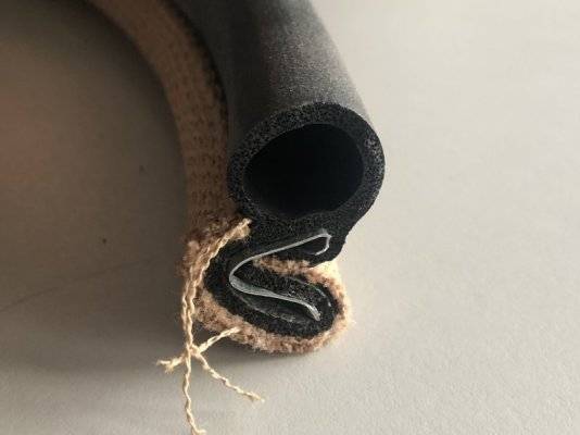

Today I replaced the cloth covered door seals that circle around the door jamb seam.
Question: The door is very hard to close now, have to slam it into next Tuesday to get the door to latch. Does anyone else also have problems with the new stuff? Seems like the weather stripping at the hinge side is a major part of the problem.

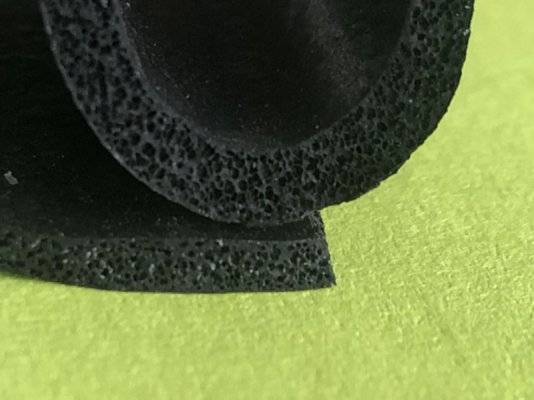

The bottom picture shows a comparison of the new vs old rubber in cross-section. The new rubber(top in lower photo) looks 50% heavier.
Here’s the trim
Below is a cross section of the new(top) and the old(bottom). The foam rubber if the new stuff looks 50% thicker in cross section.
A common problem with the early "B"s. Best solution is to replace the windlace with a thinner product. Did you check with Joe Suchy?

Thats who I bought it from. I have an email out to him, hopefully he has the thinner stuff and would swap it for me.
I was very concerned about this issue. As mine is a racecar and the entire inside metal structure has been removed. We loooked at all the gaps without the seal installed. Bending the flange inward at the tight areas helps. Mine even had an area that was very tight at the upper rear area of the passenger door. This area was trimmed and rewelded before paint. The doors shut hard at first. But now work very well. My bet is there is only one manufacturer of this material regardless who it comes from.

My Dad mentioned bending the pinch flange in a little too, I may give that a go.
We said to ourselves after seeing the difference in rubber wall thickness, "Its too bad that this is the one time that new China made parts are heavier duty than the original"
Assuming the rubber is extruded/made in china... Go Figure.
Apparently the difference between brands of seals may be the softness of the rubber, that could be true.
