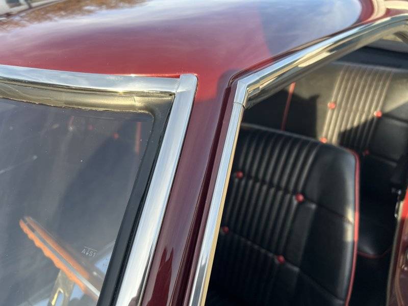

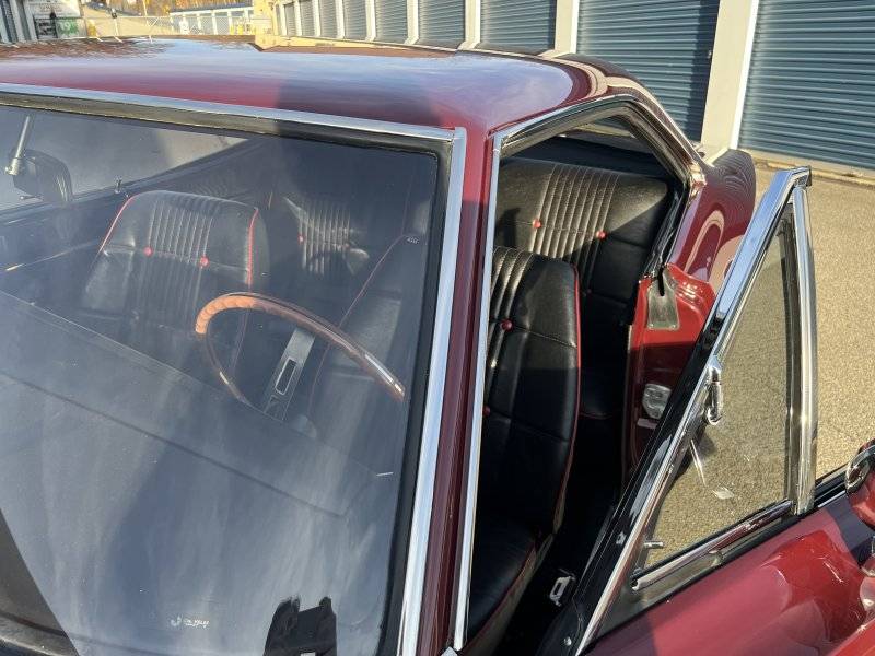

My 1968 Coronet R/T originally had a vinyl top but I had it taken off and the roof painted during its restoration. Should the pinch welds have been hidden instead of visible on a painted top hardtop sedan?

a competent guy can remedy that without painting the roof, if he has some matching paint
Thanks, I will have to drop it off at my local shop to fix it. MCR should have caught their mistake and fixed it before shipping it back to me.
Definitely !

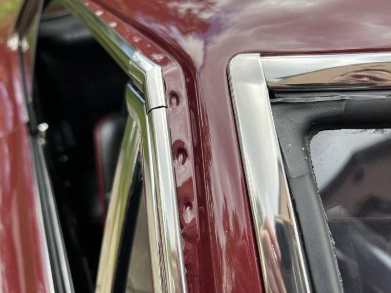

My guy missed a spot on the drivers side that hadn't been filled properly on my Bee. I got the "sometimes the fix is worse than what we've got, the trim will hide it and we'd have to clear the car again". NOPE... get out your small gun and blow it in..... and he put on his big boy panties and did so! LOL
That needs a 2 part seam sealer. Can't believe MCR missed that, it's kind of important.

Pro Comp Customs down the street from me fixed the drip rail channels. He filled them in, painted and buffed it. He cut and buffed the rest on the car to make her shine like a diamond
