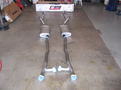

2 1/2'' are fine. Had them on my 64. Yes the manifolds with duals will help it run better and will sound MUCH better. Poly engines are happy with some up-grades however minor they may be.

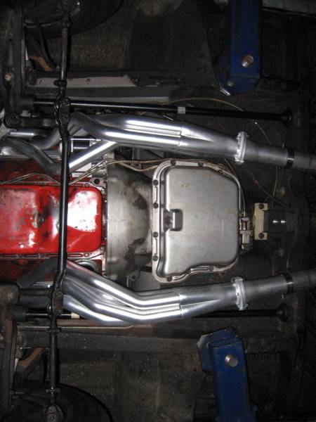

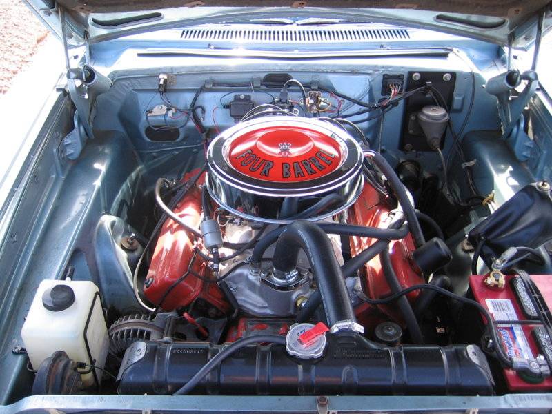

Enclosed are photos of my 64 Belvedere 318 poly when I had it. Now the photos show TTI headers and exhaust. But like you I started out with duals,(I had a local shop make the exhaust)then intake and 600AFB carb and then the full headers with complete exhaust from TTI .Really made a difference from what I started out with. Photos are for reference.
