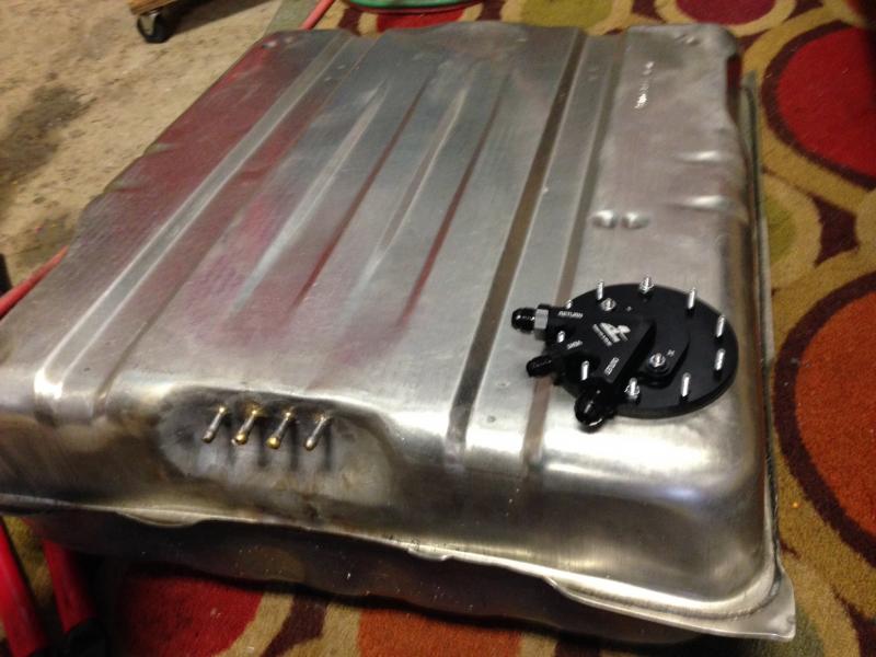

When I built my car I bought a B Body fuel tank from XV Motorsports that was set up with a pump in the tank. The piece of **** has failed already and I don't even have 2000 miles on it!! (Wonder why they went tango uniform??)
Any way, just looking for suggestions based on experience from anyone who has a similar set up with a reliable pump...what is a good pump to get ????
You should consider looking at the Tanks fuel tank and fuel pump system. They are making B body fuel tanks that look original but are designed to have an in tank fuel pump. The tanks are baffled and they have a fuel pump tray. I have yet to install mine but it looks great and the design is very user friendly. I'm adding a access panel in the trunk area to make checking and/or repairing the fuel gauge sender or pump easy.

Well, the faulty pump was a Walboro 322!!!!! Have ordered a Holley pump with same general capacities/specs as the failed Walboro. Should have it back up Thursday night....I hope!
