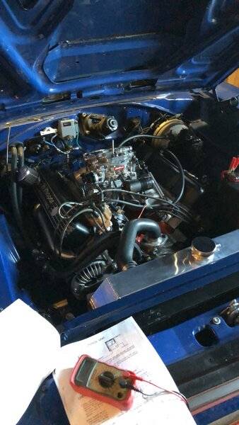

I have had problems with my charger heating up in traffic so I made the decision to an electric fan and shroud. I had no shroud
I ordered one from Champion Cooling who made my radiator. I opted for the high performance upgrade to the better fan
How ever today when we went to install it, The fan hit the water pump pulley. It is too thick
I will have to call Champion Monday but I am wondering if anyone who uses an electric fan can tell me which fan they use, how well it fits, and how well it works
I looked at low profile fans but I am not happy with the rated CFM and am worried it wont move enough air
On my Charger the only way I could make an electric fan work was by using 2, using 2 allows the fan motors to sit off to the sides of the water pump pulley. Traffic temps are way more stable now.
I'm using a Mercedes C-class fan in my 70 Charger (440 engine, 26" radiator). Space is tight (had to trim the water pump pulley bolt heads 1/16") but it fits and moves a ton of air.
