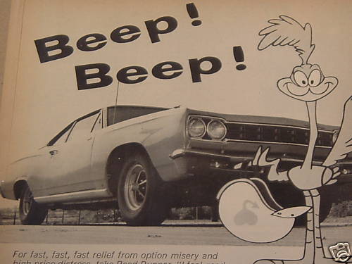

Yes, they did. In Hot Rod Magazine from late '67 (November edition), a road test/evaluation was done on a '68 'Runner. The test subject had fender-mounted turn signal indicators on the fenders (see top photo), and through the years, I knew of 3 such equipped cars which, on the build sheets, indicated they had the optional "light decor group" which consisted of at least a trunk light, the map light under the top of the dash, and the fender-mounted turn signal indicators. I have the pic showing them on here. I also have the complete magazine with article showing the car and the results. Pretty interesting reading even from back then too!
