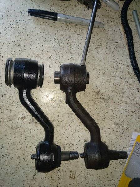

I need some clarification please. Newer idler arm is on left, old one on right. If I put the old one in a vice, clamping on the sleeves, should the arm spin? On the new one, the washers are attached as one piece and I can't see any sleeve, inner or outer.
I need some clarification please. Newer idler arm is on left, old one on right. If I put the old one in a vice, clamping on the sleeves, should the arm spin? Yes. On the new one, the washers are attached as one piece and I can't see any sleeve, inner or outer.
The arm should pivot with the washers clamped..
Neither of them pivot. Think I know my issue
I've seen some made that way... It's not correct, not how Chrysler designed it to work... The regular ones are supposed to have a greased pivot, the good ones have bearings...
I used a better vice and the old one does in fact pivot on the sleeves. The new one definitely does NOT. I took them to an old timer and he says old one is still perfectly good. I might put that one back in with a washer to take away play and see what happens.
Grease the old one good. Also I think the original ones had seals (foam??) on the inner sleeve to keep dirt and water out.
I didn't have hardware for old idler arm and didn't really want to put on a 48-year-old arm. So I went to my local parts store and got a new Moog that has the same, correct design. I tested it in the store on a vice and it pivots smoothly. I also realized my new one -- which DOES NOT pivot -- is not a Moog. It's from a certain suspension company in New Jersey that I'm certain are members on here.
