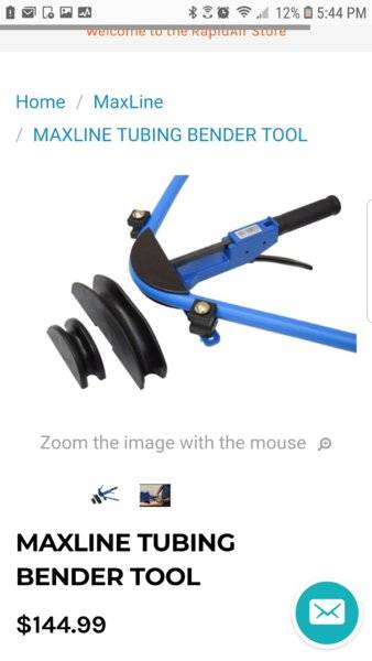

Thinking this will be the ticket, fairly priced, slick looking and easy to work with plus clean air. Yes it's a coil but after some reading it's actually rigid having aluminum in it, you run it through a die which rolls it out flat where it holds it's shape then easily bend your 90's.... looks like one slick product! Here's a link and some pictures.
https://www.rapidairproducts.com
