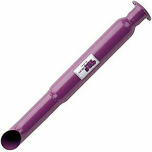

Currently have a pair of Purple Hornies on the '72 Satellite 318 with side exit. A little loud at cruise, looking to add resonators some day soon. Never a drone sound. Sound byte:
