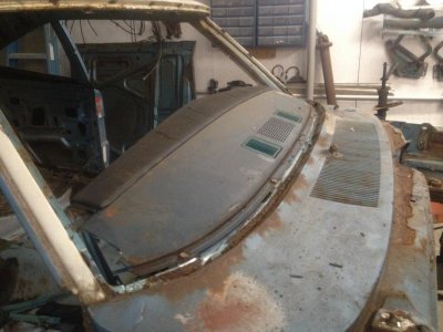

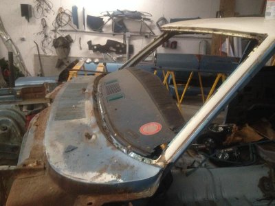

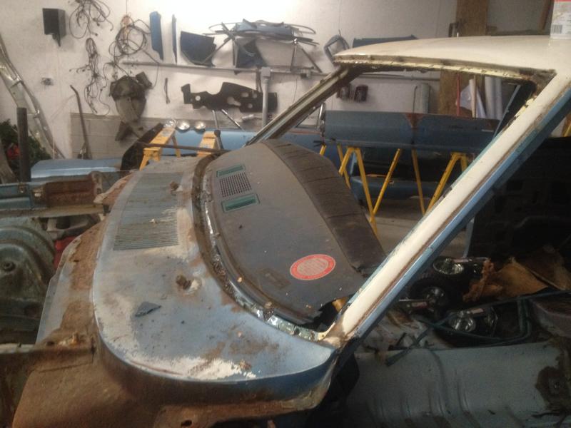

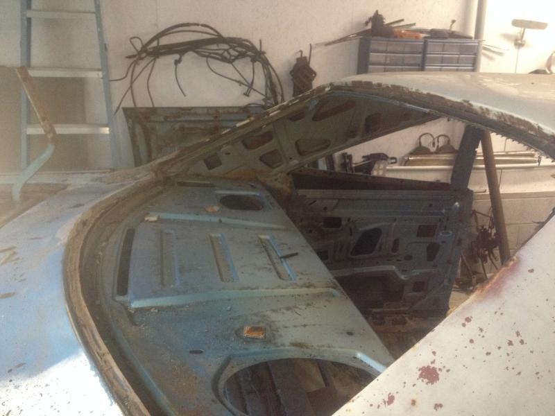

Well, I got the front & rear glass removed. Now , what is the best way to store it? Upright or lay flat as possible? It will be out of the car for a year or so.

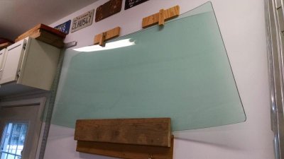

Wall space and some wood scraps. The top pieces are toggles...they pivot on the semi-tight screws.IMG_20150604_171848818.jpg
When you figure out how Chrysler got that much sealant on the back glass fence and then got the rubber on top of it, let me know.
Glass in rubber, string in channel, lay it in the opening and pull inner rubber over fence with string.
Yes that is fine.
But how does that non-hardening butyl stay in place while that happens.
Looks like strip caulk to me.
And my 67 Charger had some spongy white stuff along with the butyl.
Just put lots on and clean up the mess later maybe?
It will make a big mess when the inner rubber lip is pulled in.
Or did they have a tool to inject it under the rubber once installed?
There isn't a lot of room between the car body and rubber once installed.
If no one has an answer, I'll post this in a thread in a couple of weeks and see if anyone worked there.
