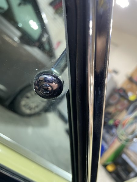

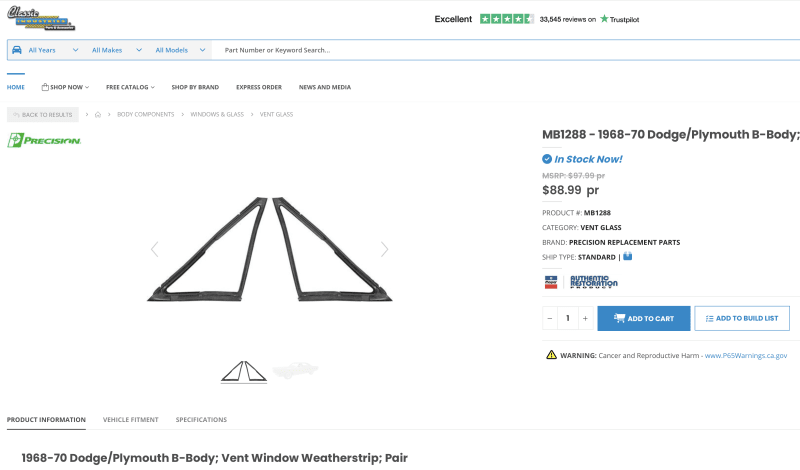

The car is a 1968 Plymouth Satellite hardtop. Years ago (when I first bought the car) I bought some door seals, jamb seals, vent window rebuild seals, etc... I replaced the DS and everything fit nicely, except the area pictured below. It's the few inches where the seal dips upwards to allow the vent window to pivot. It seems like it's too large or I've somehow mounted the seal to tight/high?? Now that I'm driving the car more, the gap whistles and rain dribbles in. I never did the PS because I wasn't sure if maybe I had the wrong seal kit. I'm asking if anyone has had this issue and knows what I did wrong or knows if a certain brand of seal would fit better. Here's the seal kit that I bought from Classic Industries 4 years ago.
Here's what the DS vent window gap looks like.

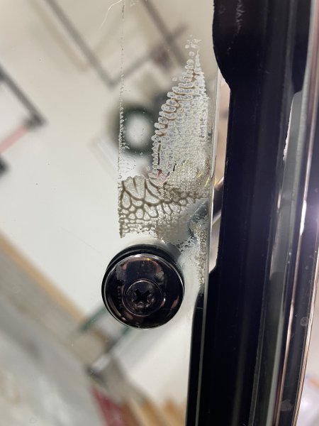

And again the same view up close (there's adhesive still stuck from when I put a piece of gorilla tape there).

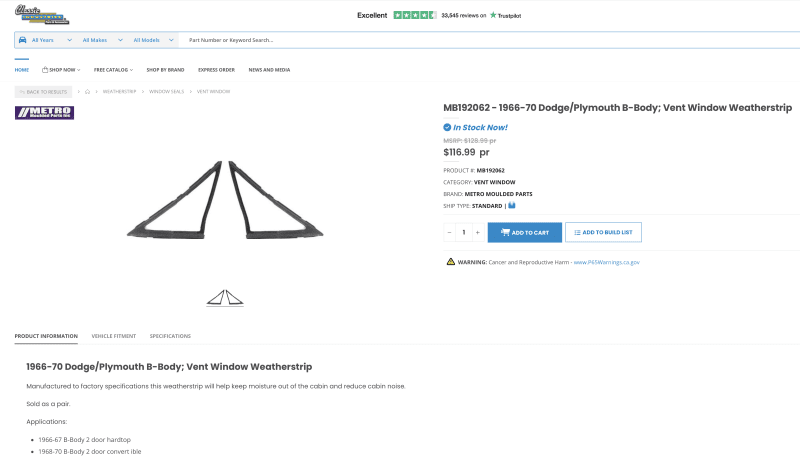

I did search Classic Industries for any other part numbers. I did find one by a different company (see below). The one I have is Precision Brand and the other is Metro Brand. I don't know if they're different at all.

Hard to tell but your glass might be to low. Try loosening it all up and reposition the vent glass. For what its worth they never sealed 100 percent from new. However your gap is very wide. Check some measurement from the other side for comparison.
Did you change the glass setting tape the glass sits in at the bottom of the channel ? Could the glass be too low in the frame . Hard to raise the bottom frame on the vent glass up unless you take the whole window frame out of the door and try to move the pin up that is attached to the bottom of the vent frame. Also, seals from Detroit Muscle Technologies are the best fit.

I didn't change the setting tape. I did order a new set of vent window gaskets from Detroit Muscle Tech. I think the vent window was at the right position (not too low), but we'll see when I redo it. I also purchased some newer felt sliding pieces so the large window slides up and down easier. Wish me luck!!

Alright.... I think I got it figured out. The gap that I had was from using the Precision gaskets sold by Classic Industries (MB1288). In my 68 Plymouth Satellite, it left a gap.

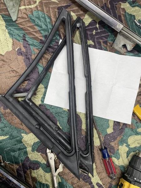

So I ordered from Detroit Technologies and got the Metro SuperSoft (WR 2308) set which works way better for me.
Here's a side by side comparison of the 2 brands. The Metro Supersoft is on the left (top) and the Precision is on the right (underneath). You have look close, but the difference is there. It's probably only 1-2 mm.

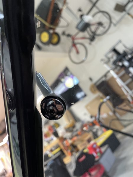

Lastly, here's the Metro Supersoft installed. It sits just flush with the vent window glass.
No air whistling .... no water leaks .... no drafts. Hope this helps someone down the road. Best of luck to all!!!
