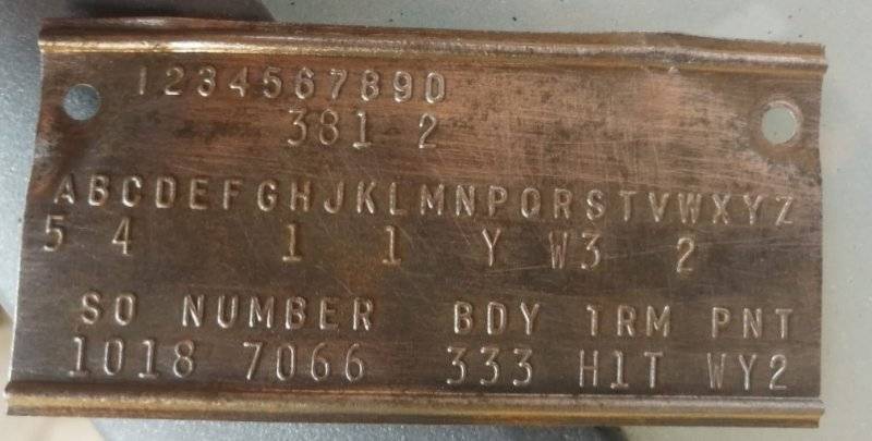

Hello, i did a bit of internet digging on this, but can't find any definitive answer. Can anyone assist me and decode my fender tag plate? I think it´s a LA plate, but i´m not sure and here in germany you cant get any information or books about this cars and all I found at the internet doesnt mach with my plate.
The VIN is 3345114252 and the plate is here at the picture. I would appreciate it if someone can help me with the fender tag shown at the picture.
1018- scheduled production date Oct. 18 1963. 7066- the rest of the shipping order number. 333- plymouth fury four door sedan with a V/8 engine. H1T- Tan, cloth and vinyl bench seat. WY2- white roof, beige metallic body, two tone paint. The rest I can't help you with as I have no LA. plant info.
