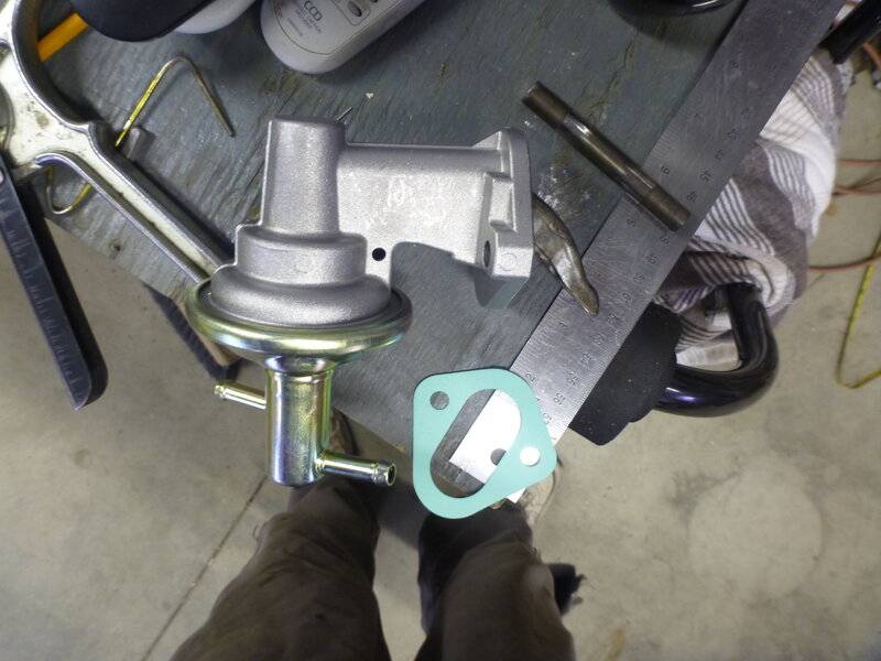

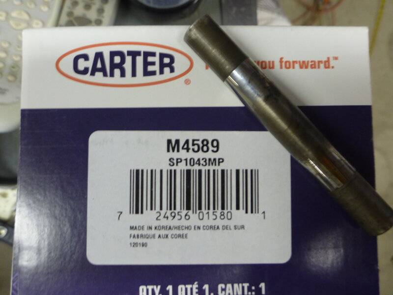

Never had an issue with fuel pressure blowing the needles on a Holley, I just by the cheapest Carter fuel pump available..
I like that pump advertising a solid 6psi, instead of 6-8psi. But I don't like that it is lacking the hard line fitting and just has 2 fuel nipples instead, my setup used a hard line to go behind the alternator.
edit: Ratings of 20 gallons per hour on the 4589 versus 33 gallons per hour on the 4845 is also something worth considering on a 450hp 440. Interested to hear opinions on that either positive or negative.
