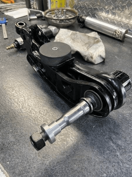

Should I cut down the rebound bumpers
some ?
I hate to take them off cus I do street drive.

Here's Malex"s solution. I beleive they're hockey pucks.
Doug
That is great idea I like those collars on the LCA shafts are those custom?
