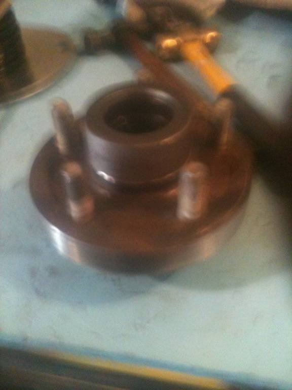

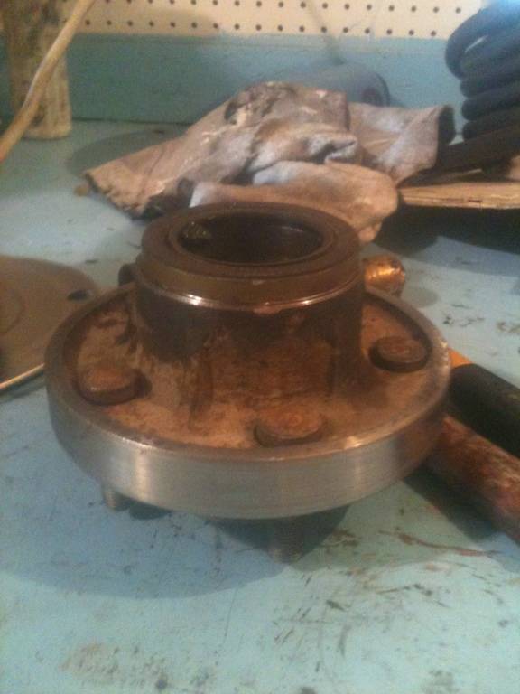

I may of figured out how to setup my dart with front wheel sensors. Hopefully my buddy will be around long enough for me to borrow his lathe and try something out. I will be trying some testing in the coming weeks

Teaser bad iphone photos. I will tell you more later :toothy5:
I dont get the deal with those pictures. I settled on building a 5.7 turbo for my 64 polara. It will be run on a factory computer out of a 2006 SRT8. I am converting it to a 6 speed manual file, turning off security, and custom tuning it. I have personally made 1100rwhp on the factory ecm with no issues
