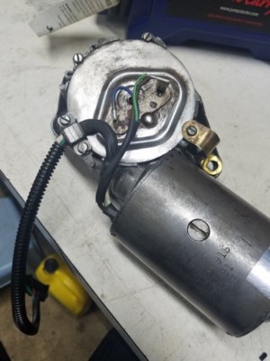

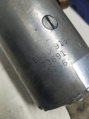

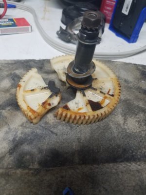

Using the steps above I have been able to get a working motor out of the 2 that I have the problem now is that the gear from that motor is broken. The gear in the other unit is different as is the unit itself. Any source for replacement output gears? See photos.
Thanks

I know this is a old thread, but I recently 3D printed a plastic gear for a nerf gun out of some carbon fiber filament. It was very effective. I don't see why it wouldn't work in this application.
