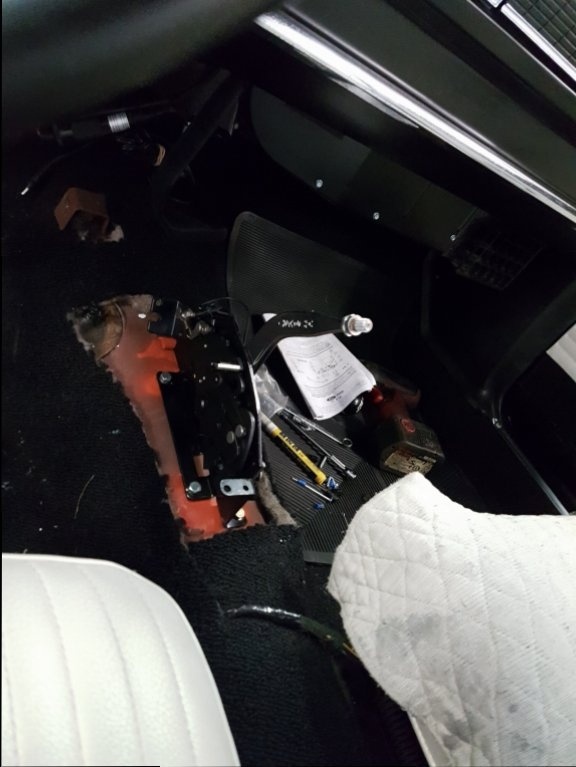

This first photo shows the Hurst sitting in place, without my console in place. What is missing here? Anyone that has done this or who has worked on the factory shifter knows that there is an entire bracket missing now..This is the FACTORY bracket that the shifter needs in order to be installed in the car. This bracket is SPOT WELDED to the trans tunnel. We CUT mine off! (it is 100% necessary to remove it in order to do this conversion!) We cut it with a wheel at the forward welded portion, then tried our luck gently lifting the entire bracket up seeing if we could break away (neatly) the rear spot welds. We got lucky and the entire rear just came away..Must have been 2 very crap welds from the factory worker that day my car was made! The result was a bracket that is perfectly able to be welded back if I ever want to go back to 100% factory! If you try this conversion please take care with that bracket. I am not sure how easily they are available, but why ruin it if you don't need to.
The next part of the process is to make sure the Hurst is sitting straight up when it is bolted down. There is a base bracket the Hurst has that has holes in it, you use these to bolt the shifter down to the trans tunnel. So YES holes have to be drilled in your trans tunnel! NOTE that we have painted the holes we drilled..Just used paint we had..turned out to be HEMI orange! WIN! To stop rust from forming on the freshly drilled tunnel. Also note in the photo below, that there is a WHITE dot, that is the position the cable will enter, since the Hurst is a cable shifter and you will no longer need your stock linkages. (I have heard of some aftermarket shifters that use linkages too..But I really prefer cable)
We shimmed with washers to get the shifter bolted in upright. NOTE! It is still OK to have a slight lean towards the driver, it is super hard to get this bolted in completely upright without making specific shims that would follow the trans tunnel curve and ALSO provide a flat surface for the shifter base to sit on. We did NOT do this. Mine is nearly straight up 90 degrees, but leans ever so slightly towards me when I sit in the car (we got mine probably 1 or 2 degrees off of 90). We made sure it was NOT interfering with the console lid in any way. SO make sure you do to.

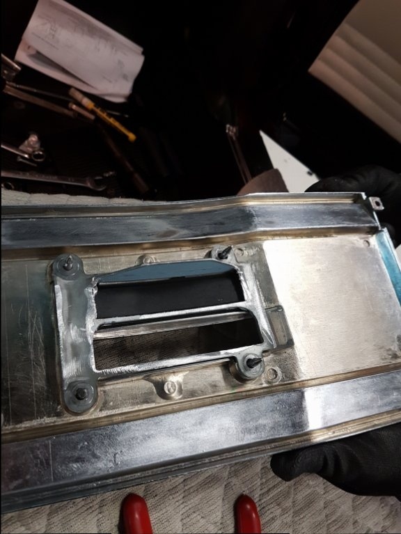

In this photo you can see the part of the Hurst shifter that needs to be cut off and smoothed. You will see why immediately when you take the shifter out of the box. Normally this portion went totally straight and of course the console lid would strike it. So it has to go..If you do this conversion look at the Hurst shifter out of the box and compare it with my photos. I marked the area in the photo below.
Now the last useful photo below is of the piece bolted with speed nuts onto the underside of the console lid. The big thing to note is how much we cut away. Normally there is an angled BOX that is covering the PRND21 slot. It is the housing that the light BULB pushes into. You CANNOT retain that. We cut the entire box away with a cut wheel. Leaving only one side of that box. I suppose we could have removed all of it, but we matched the photos I had seen on the DodgeCharger forum.
The important part to note. There is another use for this piece when in factory original configuration. That is to hold the plastic strip that covers the shifter lever slot. The plastic normally has a hole in it the same as the shifter lever. It prevents you from seeing inside the console and I suppose stops things falling in there too, like dirt etc.
When comparing mine to your factory one you can see exactly how much we cut off. Including the curved tab that normally would support and guide the plastic slot cover. I am going to make something to block the shifter hole, but right now mine is open.
If you try and leave this curved tab on the underside piece, it will be hit by the shifter when the lever is shifted into the REVERSE and PARK positions. Since both of these positions on the Hurst shifter are only reached by lifting the lever UP and then push forward. It took us a while to see what was causing the binding and subsequent LIFTING of the console lid. We thought it was happening at the front (where the lever was then located in Reverse or Park positions. But in fact it was at the opposite end of where the shifter was located. Part of the ratchet mechanism rises at behind the lever forcing the console lid to rise. This would have been bad once we screwed the console lid back down. SO make sure to check all of this BEFORE you button everything up again.

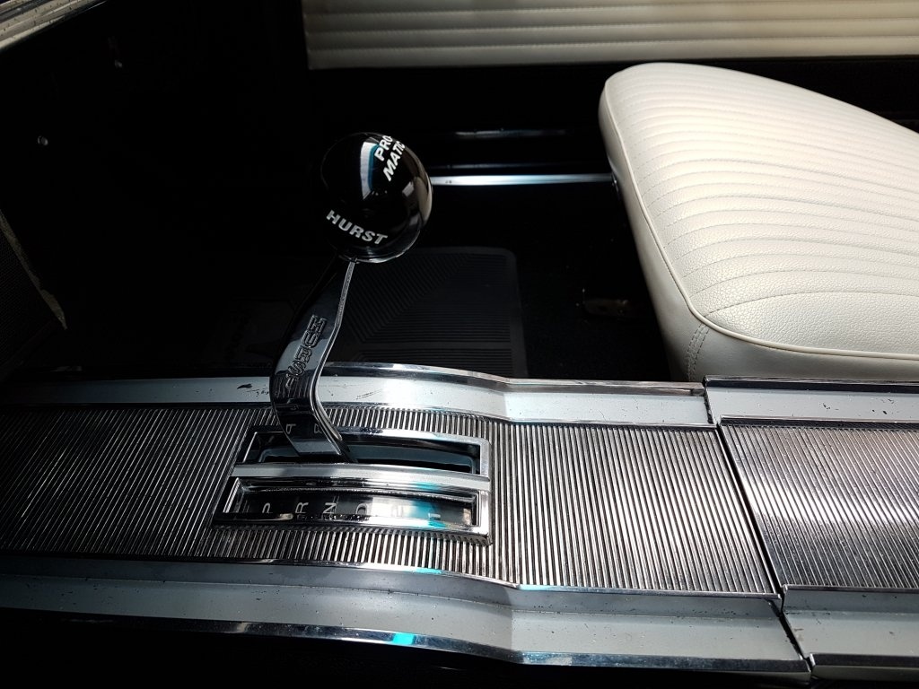

Great, thanks.. I'll post up photos of the finished product later..My car is at the workshop today.
Here are the 'after' photos. Don't mind my iLoud bluetooth speaker install! :) I do this so I can take it out easily when my car is in a show. ;)
