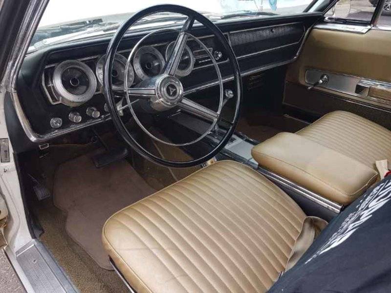

I am going to look at a 67 Charger on Sunday to possibly purchase. So far I think it was restored a little over 20 years ago. According to the pictures, it has tan interior, door panels and carpets, but the entire dashboard is black, and the kick panels are black. I know there were some two tone interiors using black carpet and tan seats in A bodies, but i am not sure what is correct in a 67 Charger. My current Barracuda has a complete Saddle Tan interior including carpets, door panels, kick panels, console and dashboard. I am not that concerned about originality and figure at worst I would probably have to dye the kick panels, because the rest of the interior looks mint, but just wondering what is correct.

Wasn't sure if I could post a picture yet as I just joined here from A Bodies Only. Here is what I am talking about. The console seems to be black as well with tan carpet. Overall I like the look, except for the kick panels.

Could have been originally gold upholstery with black carpet from what you first described. That is what S6E is.
Yes I wondered about that. Maybe they just replaced the black carpet with gold. That would explain the dash and kick panels.

“TRM” This is the interior style & color. There will be numbers & letters under all 3. The “S” under the “T” stands for “Sport Interior”, The “6” under the “R” stands for premium grade vinyl on the bucket seats. All 67’s should start with “S6?” so we will concentrate on the letter under the “M” which is the color of the interior.
A= gray & black
B= blue
C= white & blue
E= black & gold
K= copper
M= copper & black
P= white & turquoise
Q= turquoise
R= red
T= tan
V= white & red
W= white & black
X= black
Y= gold
So it will either be S6B with black carpet or S6Y with gold carpet.

Went and saw the car today. It was originally a black and gold interior, also a G code 383 two barrel car. It was solid but could use new paint and an interior refresh. A lot of electrical issues as well. All in all not what I am looking for. The decoding guide was awesome, I was able to verify everything on the car.
Does anyone have a picture of the gold and black interior? A Google search didn't turn up anything. Thinking about giving this car a second look, and wondering about changing the carpet back to black, as the interior needs a refresh anyway.
I think it would look fine. My Toyota Avalon has tan interior/ black carpet. My 66Satellite has all gold interior and a black carpet would accentuate the gold.
