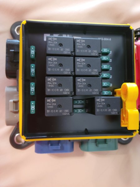

I decided to use the Eaton 31S-004-0 8 Relay, 8 Fuse, 200 Amp VEC to control power to the headlights (2 Relays), cooling fans (2 Relays for puller fans, Optional 1 relay if I need a pusher for the A/C?), A/C clutch (1 Relay), horn relay (1 Relay), 1 currently unused relay?

I decided to use the Eaton 31S-004-0 8 Relay, 8 Fuse, 200 Amp VEC to control power to the headlights (2 Relays), cooling fans (2 Relays for puller fans, Optional 1 relay if I need a pusher for the A/C?), A/C clutch (1 Relay), horn relay (1 Relay), 1 currently unused relay?View attachment 1487642

Those blocks are nice too, I like the bussed fuse power and relay coil negative but for what they charge they should include the field side of the main connectors....but now I'm just bitchin'!:D
Be sure to double check everything. I had a few wires swapped around on the last one I had ordered. The colors were correct, just that the pins were in the wrong place on the connectors. Easier to find when it's still on the bench.

Freightliner uses that type of PDM box, sell a lot of them, also the green pigtail. I’m sure it’s due to more electronics & everyday usage over the road.
