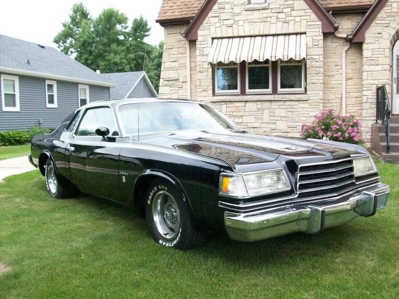

If it is a 360 (E-58) Police Package 4 bbl great. If a 360 2 bbl still O.K. but will have the lock up torque convertor at 50 mph. No big deal. If it runs and drives with the Lean Burn then another plus. As far as rust, the worst is the underside of the car. Especially check for rust on the rear of the leaf spring as thy could rust enough to come through the trunk floor. Check for rear quarter rust including the back side of the rear quarters. Parts are still out there if needed. Good Luck. Here is my '79 Magnum GT.
